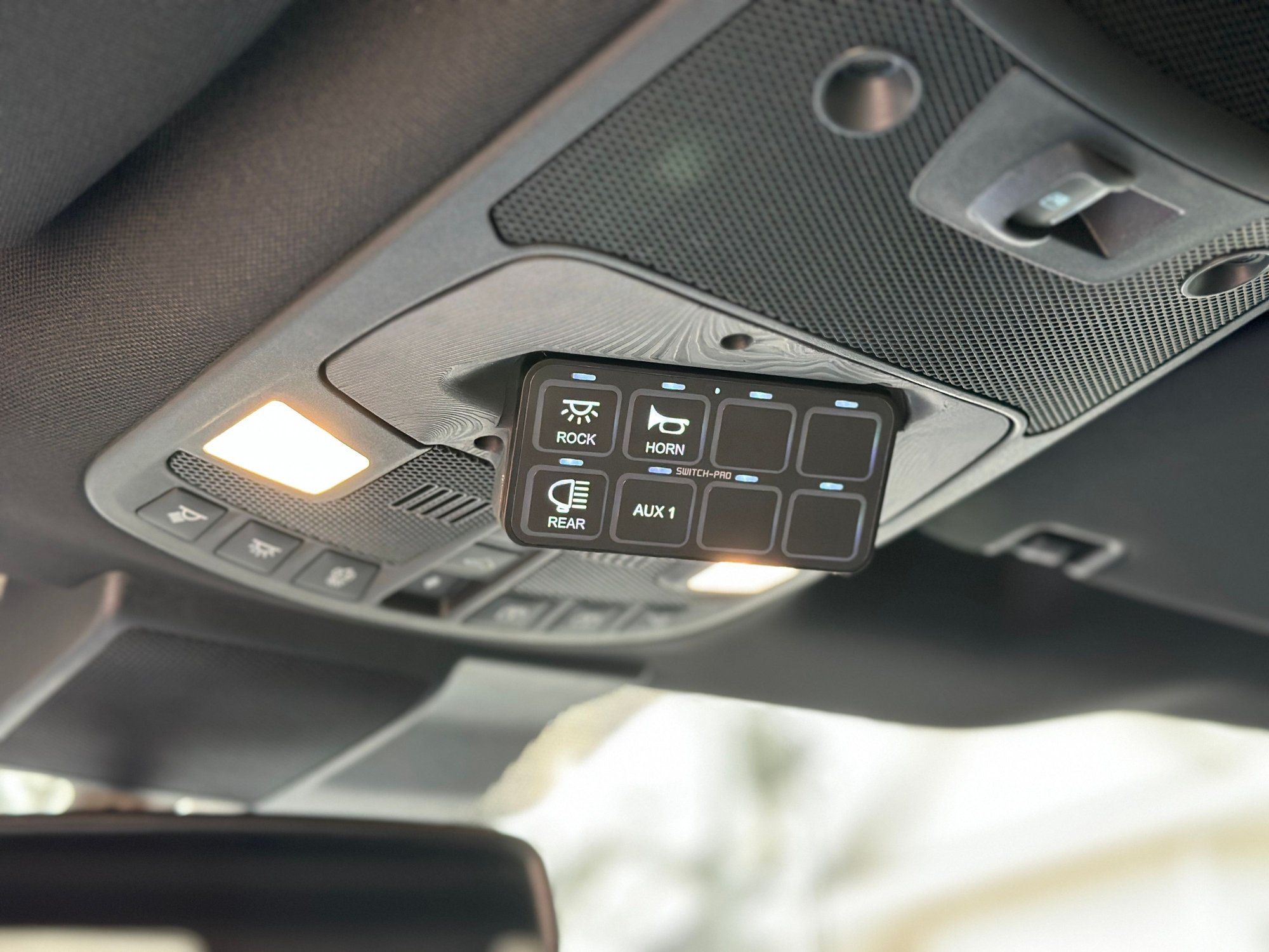

I added the Switch Pro to my Platinum and love it. It looks better than the generic up fitter switches, can be programmed to match the interior color of the Fords, and the switches can be programmed to any type of switch you need. On-off, momentary, ect, ect. Multiple people have mounts for them but I went to one from Swarfworks that takes the place of the taco holder (sunglass holder) thats borderline useless
https://caliraisedoffroad.com/produc...RoCct4QAvD_BwE
https://swarfworks.com/switch-pro-sp...7-ford-raptor/
Here is mine
