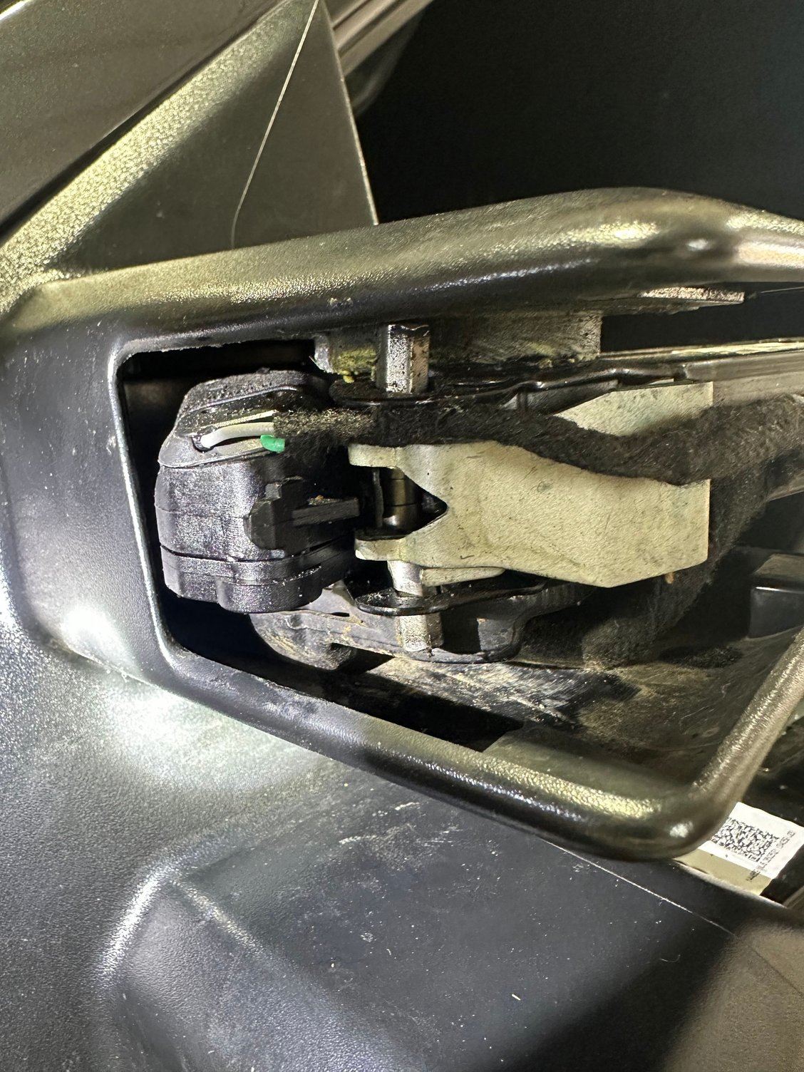

2022 F350 was backing out of garage and mirror got hung between garage door rail and truck.
When it would auto unfold it would keep opening to about 120° rather than normal 90°.
Tried resetting, opening/closing, everything I could find to do with no luck.
ford quoted $2000 for a new mirror assembly.

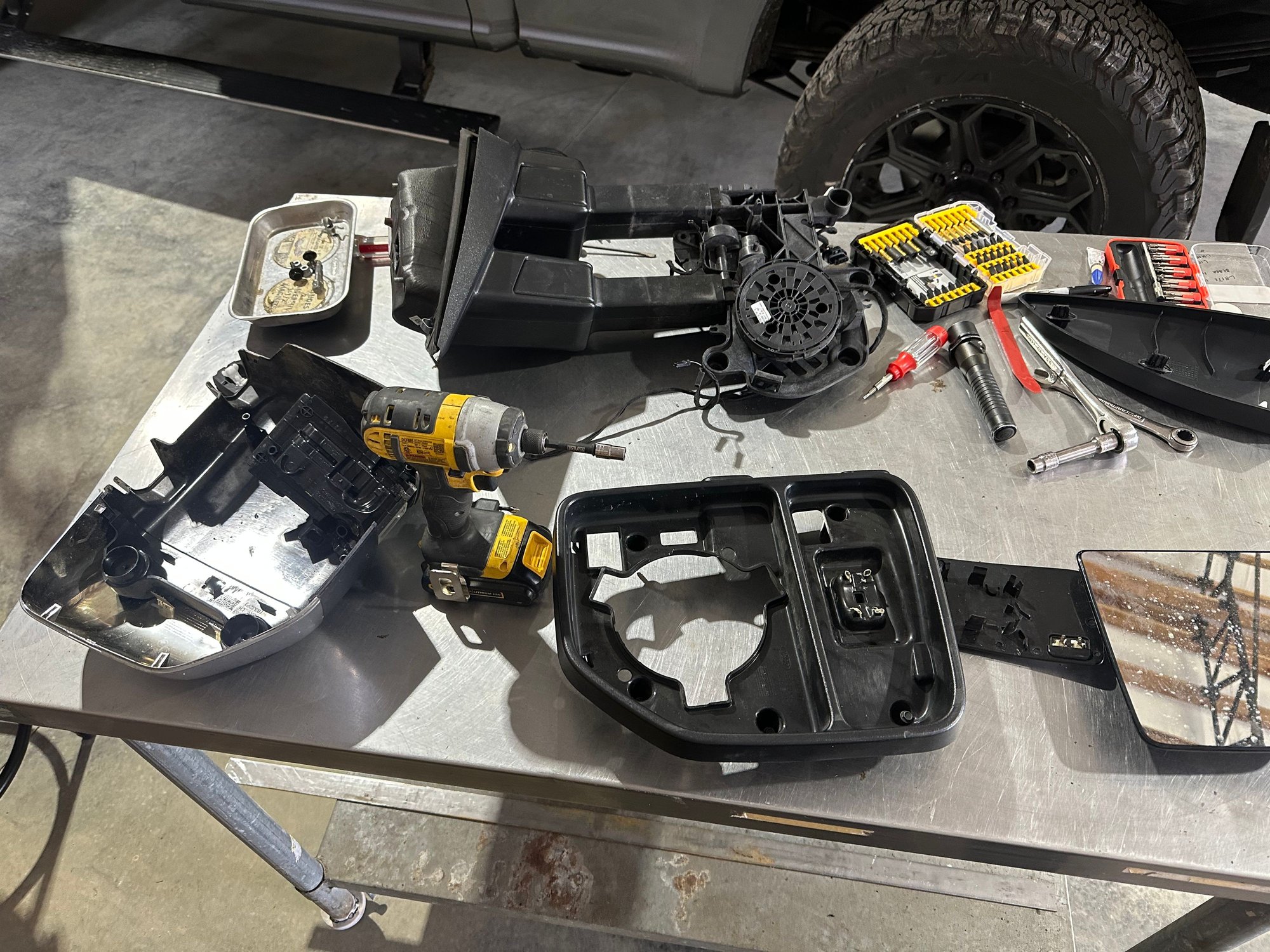

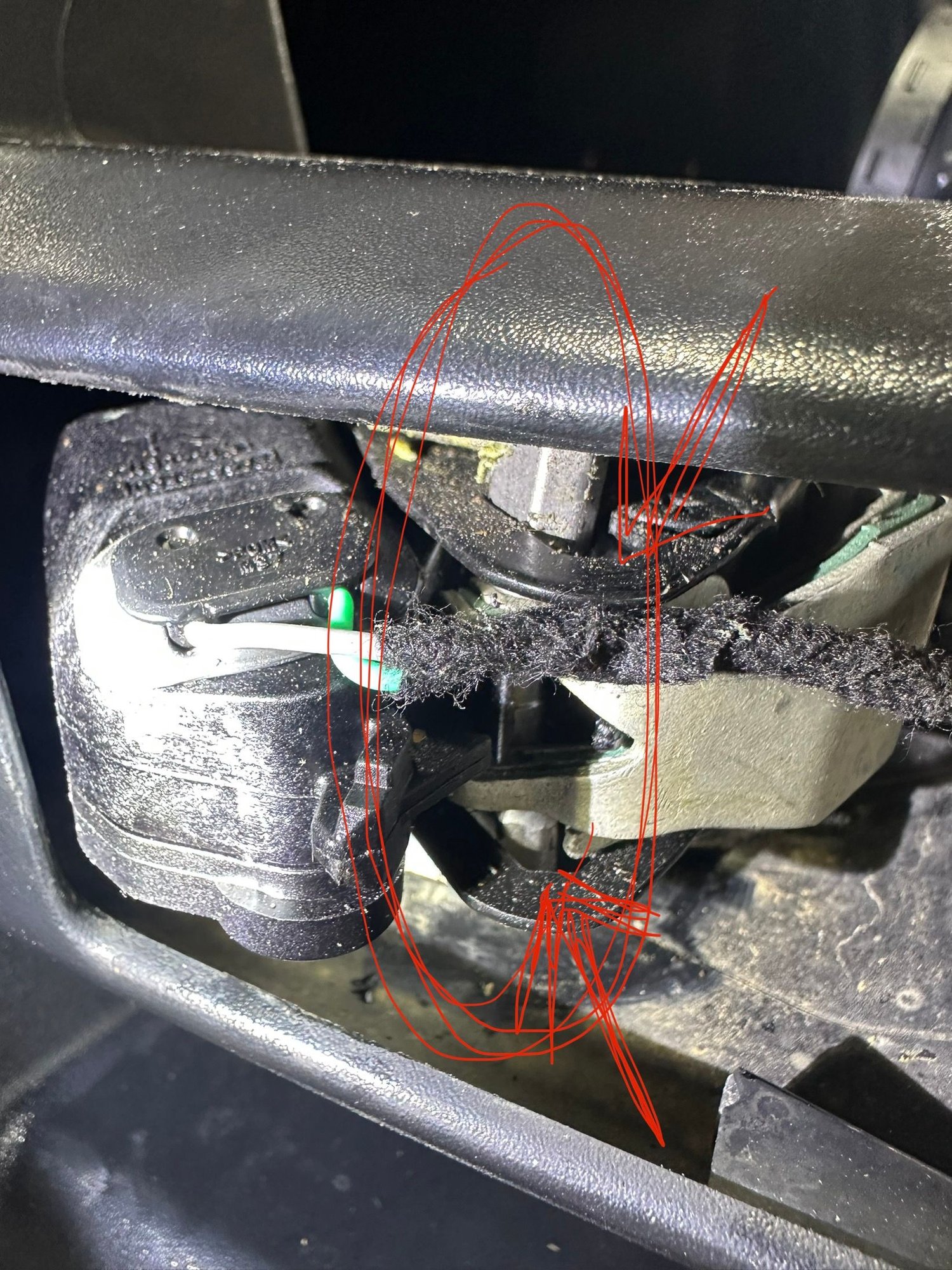

well I tore it down and found the issue. Nothing was broken. There are 2 vertical rods about 1.5” long on the top and bottom inside where the pivot points are.
when the mirror gets hyper extended the rods, which have about 1/4” slide ability, slide outward I guess to prevent damage.
the rods did not reengage, causing the mirror to not know to stop at 90°.
simply take a flat head screwdriver and hammer and tap them, they snap back in place. Fixed!!!
hope this helps the next person who isn’t paying attention backing out of their garage at dark.
see attached pics.

How do you get to those pins
Thank you rhino_160, I need to do this fix but I’m confused about how you got to the interior part of the arm to access the hinge and pins. Do you have to take apart the entire mirror like in your photo? And if you do, how do you open up the arm area that has the pens? I watched all the disassembly videos I could online and cannot find that part.
Old Oct 14, 2023 | 07:57 PM
Tearitin's Avatar
Tearitin
Joined: Aug 2017
Posts: 31
You have to pry the arms apart at the seams, I used a small pick to get it started and then it just snaps together.
