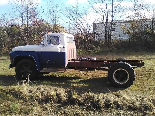

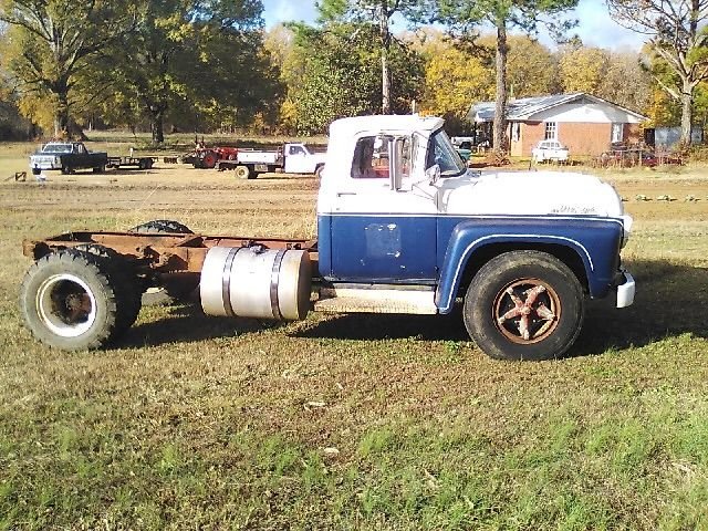

It is still a work in progress, and I will post more pics when I’m done with it.

That is a cool big job!
