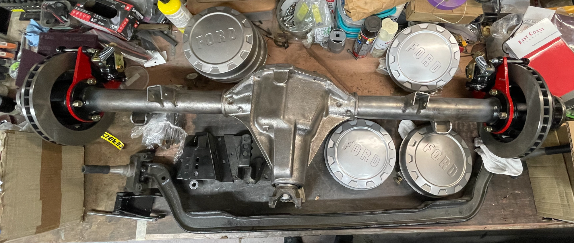

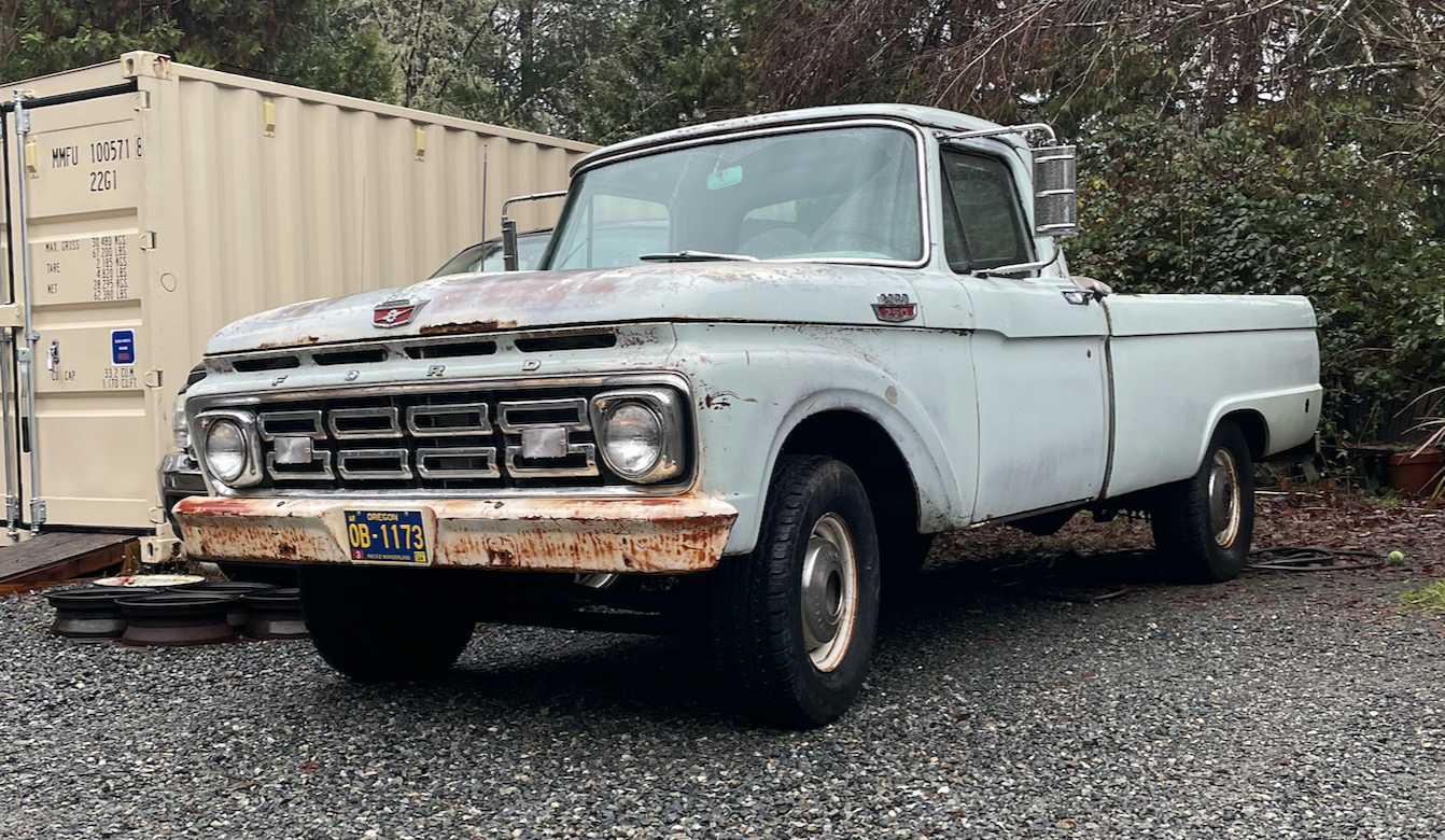

Not sure what your current gears are now but I am in the process of swapping the 4.56 Dana 60 in my '64 F250 to a 3'73 out of a '68. I am upgrading the brakes as well in the process as the guts of the 68's drums were gone and this disc conversion will make towing more predictable. Mine has a MX Cruise-0-Matic now and I am hoping to get it more hwy friendly but still be able to tow if needed. It's my daily driver. I have heard a 4.11 is a good option as well but I was able to find this 3.73 local so that drove my decision, I wanted to keep my original rear end the way it was a just put it aside so swapping the whole thing was a better option for me.
68 Dana 60 with TSM Mfg disc kit & front 3" drop axle.
64 F250
