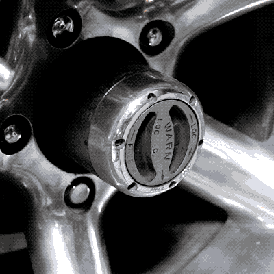

I've always packed em with whatever grease I'm using on the bearings. They get a little sticky when it gets cold, but if you work them regularly over the year they aren't that bad. The synthetic grease seems to be a little better in the cold.
They also sell a tool that's just a big plastic **** with lugs that makes it alot easier.

My hubs get exactly the same grease as my front wheel bearings as there is no partition between them. If I put oil in them hubs, then I'll have oil in them bearings too. I use only Moly fortified Ford disc brake spec Valvoline grease, VV632. It works.
I made me a **** to turn the red hub ****, but I like that fancy blue one. It really is easier than finger tips in ice filled cold recesses. An internal spring "locks" the hub, the red **** only uses ramps to push the lock ring apart to unlock the hub. When locking hubs, the ramps just move so the spring can push the lock ring into engagement.
https://www.google.com/search?q=ford...=firefox-b-1-d
At first I was like, "Thanks- yet another tool that I 'have' to buy now that I know it exists." And then I remembered that I have a 3D printer...

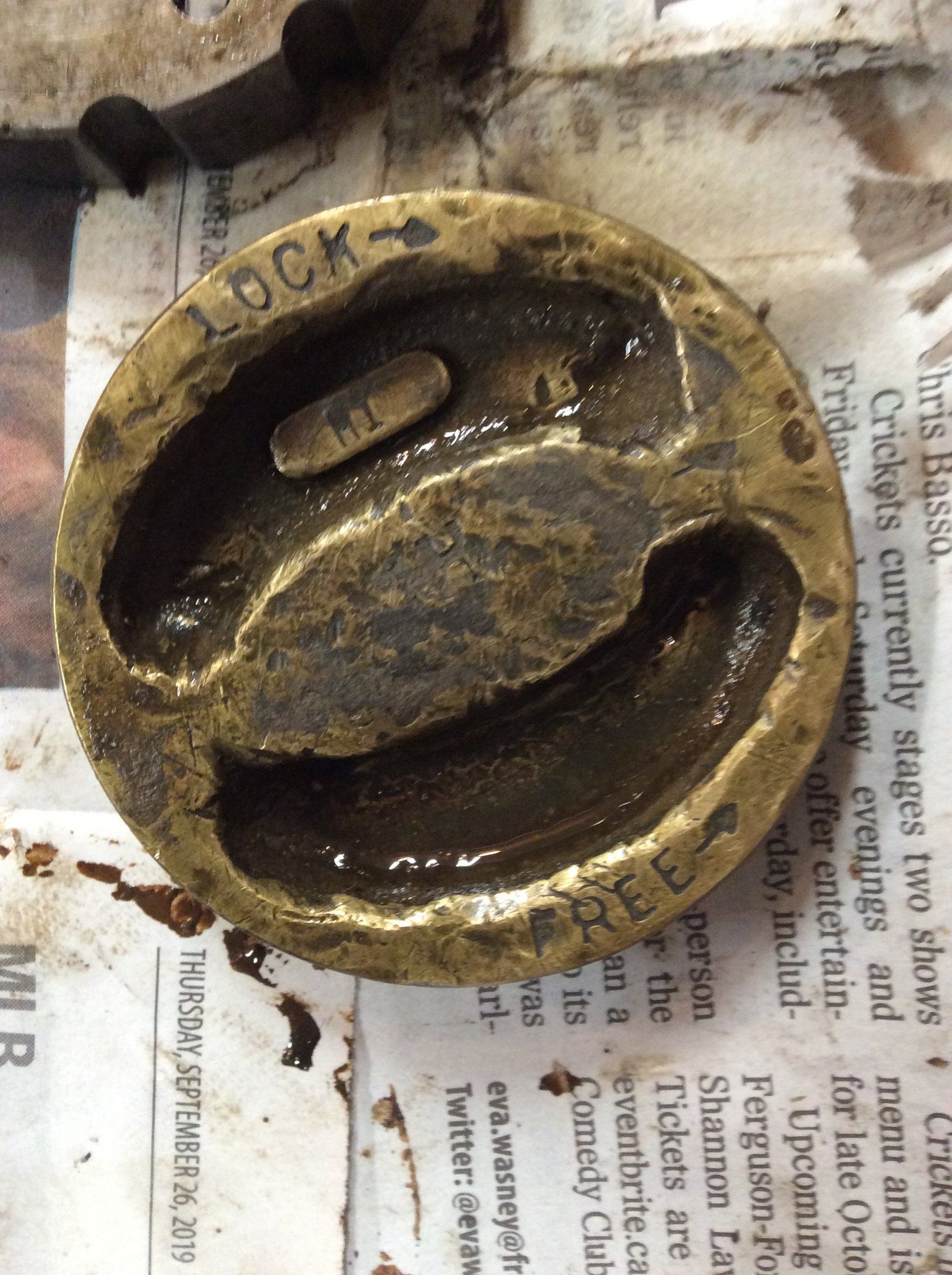

And if you do not maintain then hubs properly here is how they can look. When you do NOT have that tool, or use the wrong tool a bunch of times.
