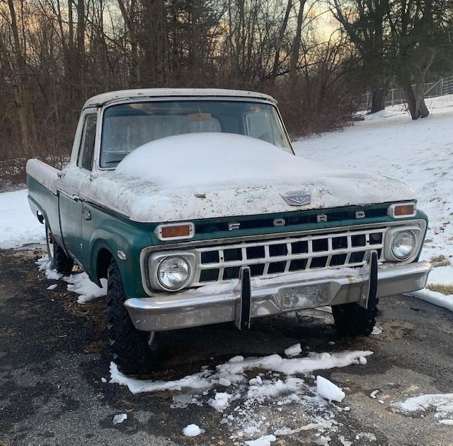

Starting around 2009, I began my career in a small city of about five square miles in NY. As a car guy, I got to know what cool car or truck belonged to who or what house they sat behind etc. One such gem was a 60's "F100" that sat behind an old vintage house, being used to hold wet leaves . I got to know the owner a little who also had some muscle cars and an old Jag as well.

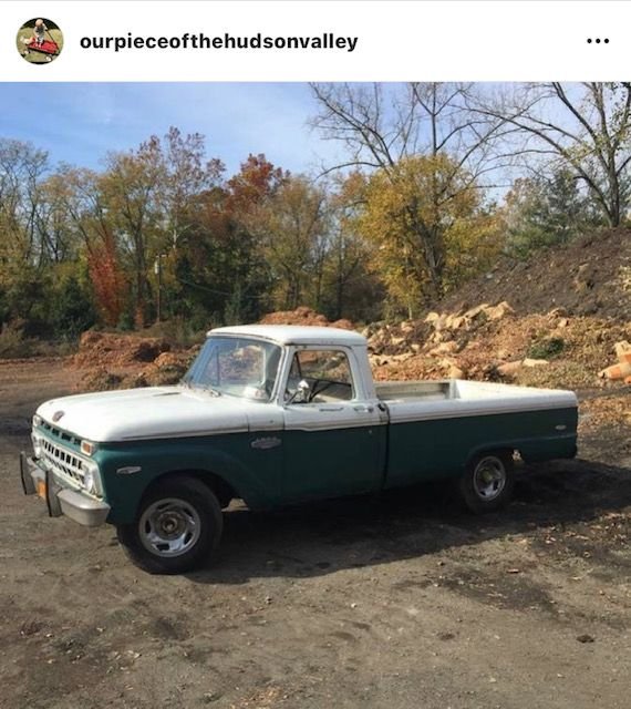

Several years later after I had transferred to a larger job, and while activated by the national guard, I set out to purchase a project truck with some of the military money. After originally searching for a bump side, I saw the above pictures on craigslist of a f100 with no year listed and the owner asking way too much money. I recognized the truck and tried the number and e-mail in the add but both were wrong. That same day, I swung by the house to see what the details were and found out the owner hadn't really wanted to sell any of his vehicles but his wife was making him cull the herd by two. We had a beer and talked for a while. The truck was originally a sand shell beige 2wd 1965 F250 custom cab that someone had farm painted green and white (even painting across the light reflectors with just the lenses removed!) and added f100 badges I'm guessing due to the 65 F250 emblems being one year only. It had dodge chrome wheels, dealer installed bumper guards and rust issues. Drive train was a 352 FE with a NP435 four speed/granny low and a 4.10 dana 60 locking rear. The truck was originally owned by an apple farmer in NY and then bought by the second owner who used to to haul large beams from a mill for his house restoration. It had been parked for about 10 years and started on the first try every time. We reached a price 1/4 of his asking and I drove it 40 miles home Roadkill style on a major interstate with one bad brake hose.

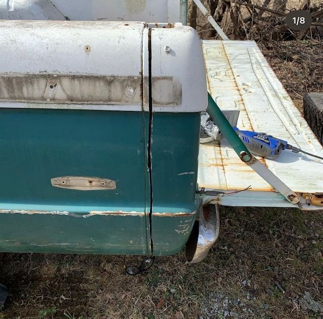

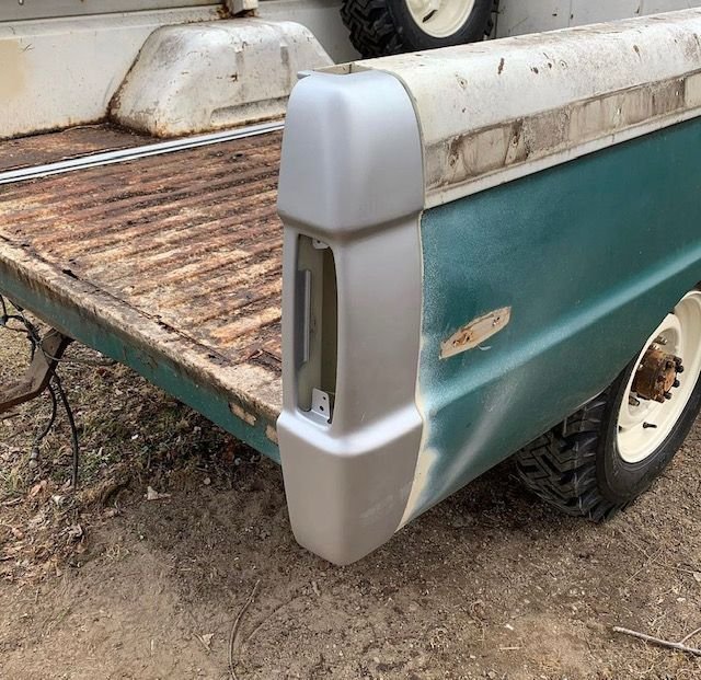

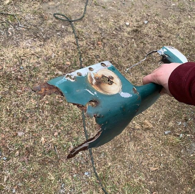

Well as many of us know, working outside on a gravel driveway, away from a power source sucks. At this point I cut off both old bed extensions which had been fitted with marine looking reverse lights and lots of bondo. I test fitted repops made for a bronco and they fit well enough. I took the advice of John Glenn who has some of the coolest build threads on slick60's and on here and cut down behind the seam to take off the extension and then drill out the remaining spot welds. Not bad for my first time doing anything like this. Thanks John! (Metalwork Yoda)

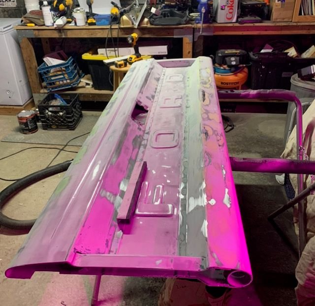

More basement bodywork! The tailgate was in good shape minus the important part on the bottom
Scrap To Art Metalworks has a great youtube video explaining how to take a piece of pipe with the same outside circumference as the stock tailgate bottom and replacing the whole bottom of these gates. This is the link:
I ordered a piece of 2" OD steel tube with the same ID (.120" wall) as the stock tailgate pivots from Industrial Metal Sales. I made locating brackets on the old tailgate so that the pipe would be in the exact same spot as the stock pivots.
After cutting off the bottom of the tailgate, I treated the inside with rust mort and then welded flat sheet metal from the tube to the tailgate on both sides. Eastwood cavity spray was used in every point possible. I bought two cans and made a double length hose to reach everything.
More tube with a .175" OD was used to set the side to side movement of the installed gate. I drilled the bottom of the tailgate/pipe and rosette welded the "plug". This pic was before finish welded and bodywork.
Eastwood SCT was used to strip everything down, not as good as blasting but I was and always am still learning.
Bodywork with eastwood products and sealed in 2k primer. Red glow was from tomato grow lights in the basement. Bodywork was finished on the gate and sprayed with 2K primer. It's still waiting on sealer.

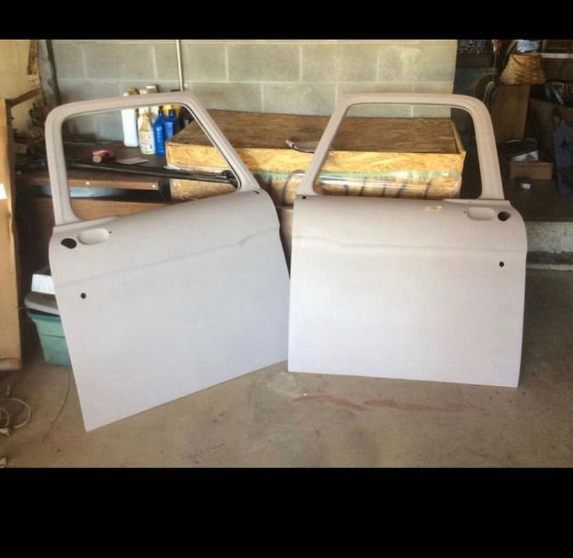

At this point we started fostering and getting the house ready to sell. I was going to finally get a garage and we needed more bedrooms. That didn't stop the parts collecting though! PERFECT blasted and epoxy primed doors after a four hour drive to Greencastle PA ($400) to replace the rotted out pair on the truck.

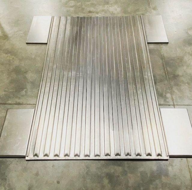

Finally, the big purchase of a complete bed floor from sschassisworx ! Mine is in the crate so this is a picture I stole from their site. Not pictured is the front bed rail and rear wheel wells also purchased.
