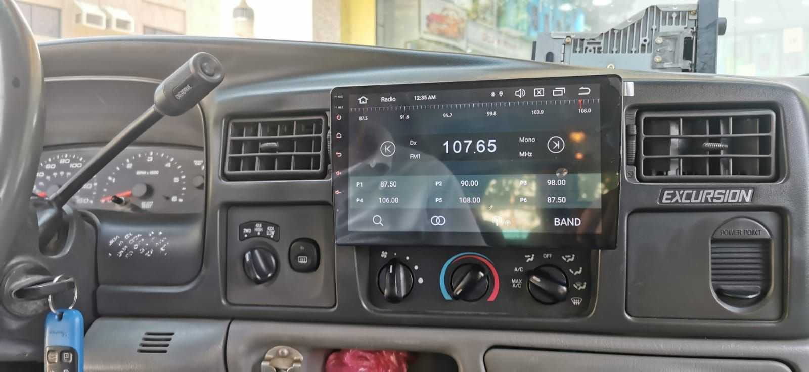

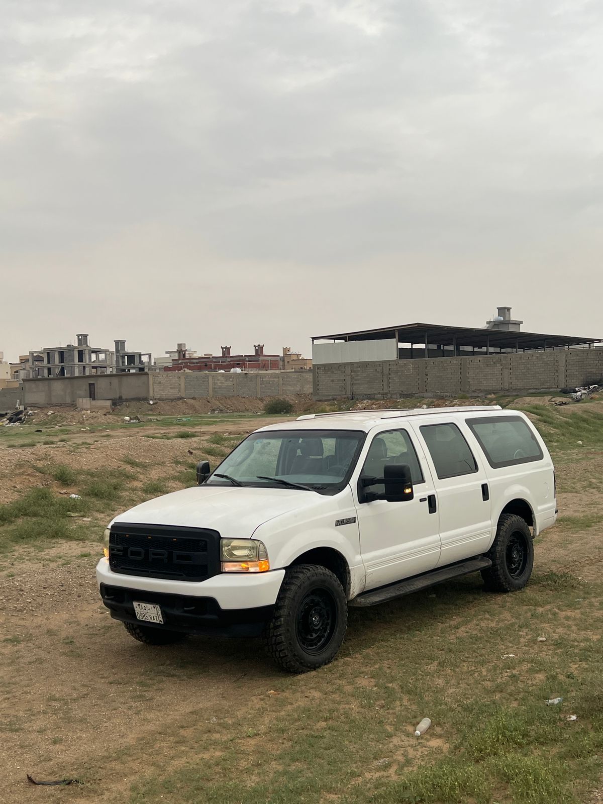

Bought 2004 Excursion; Beluga
Im the proud owner of this white Whale.
Has 55000 miles on it 4x4
already made some mods for my daily driving:
20" Rhino wheels
towing mirrors
re trimmed center captain seats from an escalade
roof rails from an escalade
rear light
body colored bumpers
entertainment screen
grill
Next up: headlights the Cold air intake, exhaust, and Programing
What do you think?
New headlings coming
waitng for spacers
headlights are here

About the Escalade roof rails, were these a direct bolt on, or did you have to create new holes in the rails, or the roof?

the rails for the full size escalade were installed with the existing holes 01_Excursion

The escalade roof racks look nice, I'm gonna assume the cross bars wont fit because of the overall width of the excursion compared to the escalade, I’m about to go measure I have both trucks

on the escalade measuring inside the rails it measures 45-3/4 can you measure the escalade rails on the excursion, I'm trying to see if the cross bars can possibly fit for my roof rack

I didnt bother with the cross bars as not planning to use it it is just cosmetic for me.

do you mind sharing wheel offset, width and the tire size, any rubbing? Did you have to trim anything?

sure rsqfxr the wheels are Black Rhino Arsenal 20x9.5 ET12 all round tires are 275 65 20s no rubbing on full lock no trimming required

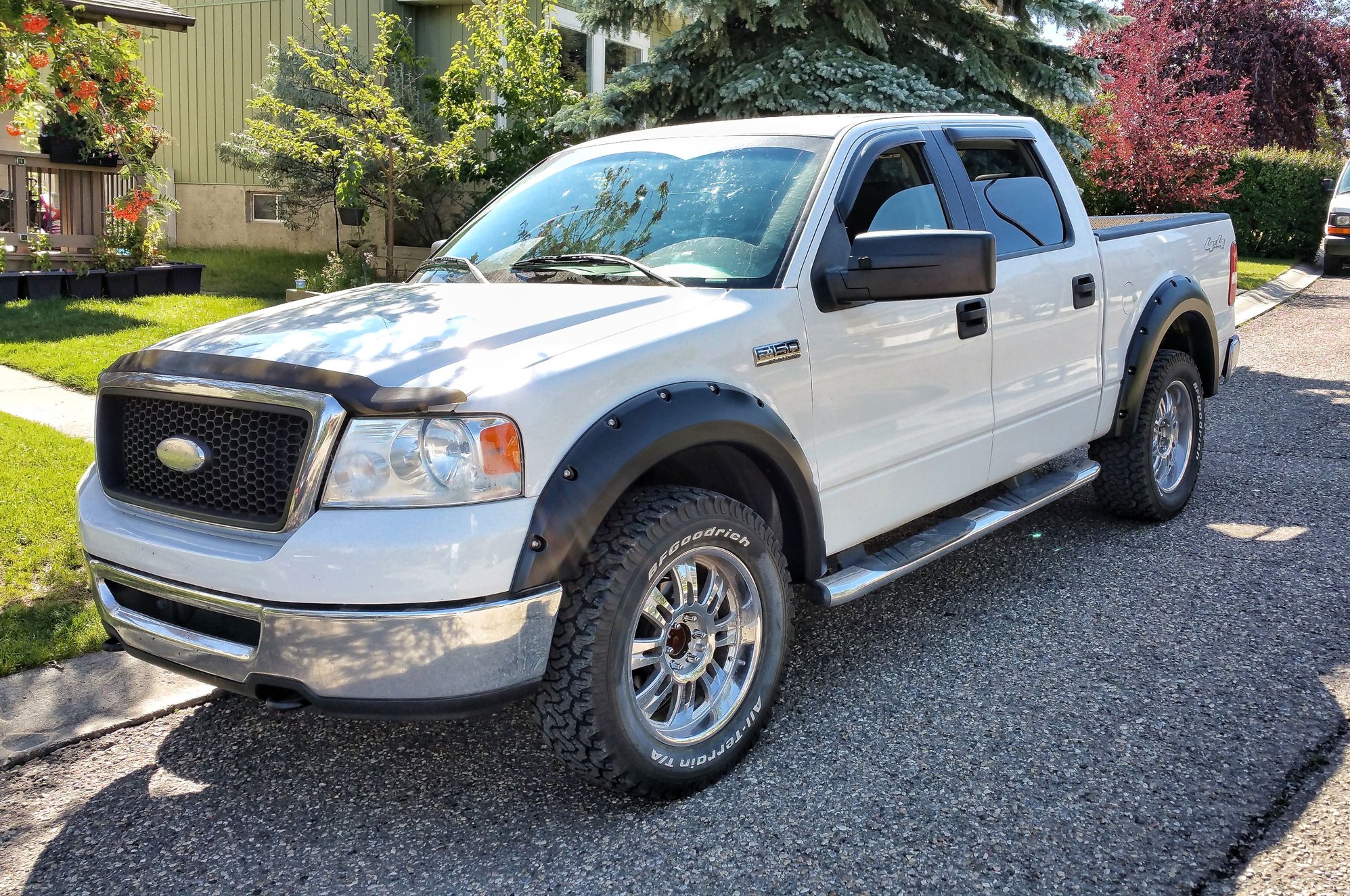

Looks good. Very clean with the white and black. Like the Grill particularly. Did you purchase it online?
Bushwacker fender flares? Contemplating those too. I've got an Eddie Bauer so I keep wondering if they replace the stock ones, or go over them.

2003EX yes got the fender flares online https://www.ebay.com/itm/293299223046 the are a lot like the ones on the Raptor, will get them installed as soon I get the spacers to fill them out as they are 2" + - wider then my wheels giont to leave them black for now see how i like them without paint
here is the link for the grill https://www.ebay.com/itm/175424179057
i bought the 2005 one by mistake, but trimmed the bottom to fit my 2004

Originally Posted by TTsam
...will get them installed as soon I get the spacers to fill them out as they are 2" + - wider then my wheels giont to leave them black for now see how i like them without paint.
Thanks for the links!
I think they look pretty good in black. I had a White F-150 with the BW pocket flares in black and thought it looked great.
