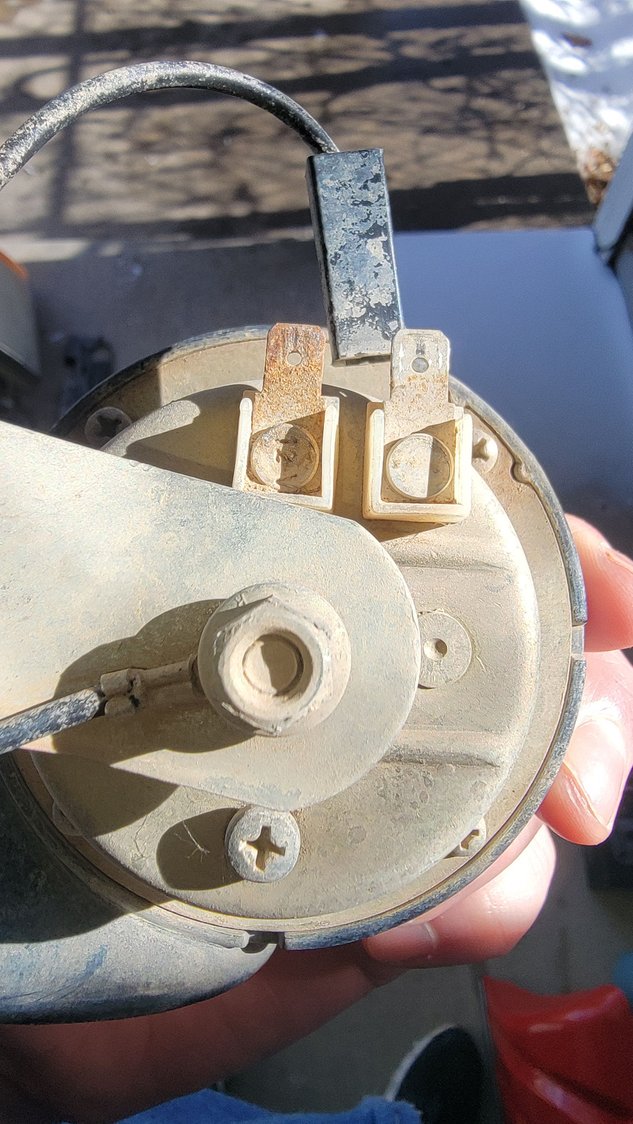

Thank you so much I will go buy alligator clips...how do I know which part of the horn is negative? I attached a photo of it. One of the little metal pieces says "12v" but It does not day which one is negative or positive.

The 1 mark 12v should be positive. You can take your multi meter on continuity mode and check the the 2 terminals to the nut with the wire and it will tell you which 1 is ground.

Dave,
Both of the tabs on that horn may be for 12v and it is using the frame mounting bolt for the ground side. So be sure the mounting bolt mounting bracket is also nice and clean if the horn is to be remounted on the truck. If you plan on doing a lot of work on the truck and keeping it for a long time get yourself a can of this to help with electrical grounds and connections.

seeing as that is an aftermarket horn, my bet it is burned out.
they don't last very long these days with all the chinese made junk.

my apologies for the late reply but I wanted to say a big thank you for all of your help! I did the wire testing via the battery and the horn did not beep. I ordered a new one on Amazon so hopefully that does the trick! Once again thank you being kind and helpful to a complete stranger...especially one who is trying to learn basic mechanical skills!
