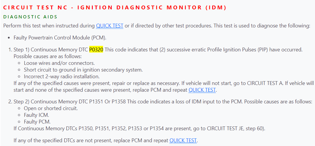

96 f150 inline 6 po320 code only
Spark plugs, dist cap, sensor in the dist cap, alternator it's straight wired cause I lost the key and many more parts replaced.
truck will run for about 20 to 30 minutes then just quits. No spitting or sputtering. Just dies. Then have to let it sit forever before it restarts.
​​​​​​This has been going on for about a yr and was happening when I tuned it up as well

This code means that your computer can't see the pip signal from the Distributor. The fact that your engines dies too indicates the the ICM can't see the pip signal either. Let me guess, your tachometer doesn't move while you crank the engine? And your check engine light doesn't extinguish when you crank the engine (it's suppose to)? All these signs indicate a pip sensor that is getting hot and failing.
Solutions are to pull the distributor, and disassemble the distributor, and replace the pip sensor, OR buy a complete, new distributor. Be careful thou, sometimes the new/rebuilt distributors are assembled with low end components that fail after a short time.
Rockauto has replacement motorcraft pip sensors (they call it 'distributor pick up coils' which is a GM term) for $44 and you can't get a better brand then that.
