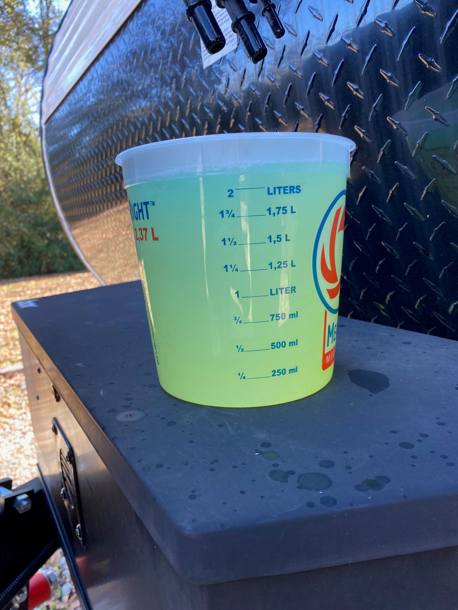

I guess mine is a mixture of clear and green... LOL. Here's mine when I drained the lower fuel filter before changing it. It's "B20" with Hot Shots Winter and Better Diesel FBC additives added in. Of course the container it's in isn't exactly clear either though... But every time I have drained mine , this is the color it has been.
are you in a cold area?
Right now I am! I am in north MS. The high today is 16! I know "cold" is subjective, but with the wind blowing right now we are at -4! That's cold to me! LOL
great info
and the b20 is holding up in terms of not gelling?
great info
None that I am aware of. I switched over from Hot Shots EDT to their Winter Blend additive probably 5 or 6 weeks ago I'd say... once I saw that we would start getting below freezing temps I switched then and will continue to use the winter blend until spring time. I also get my fuel from a high turn over Shell station here in town that is only about 3 or 4 years old. I haven't asked anyone at the station if the fuel we are getting is "winter blend" (and I don't imagine they would know...) but I imagine it is. I just changed my fuel filters for the first time a month ago and like I mentioned, it looked like the new one at 15K miles.
