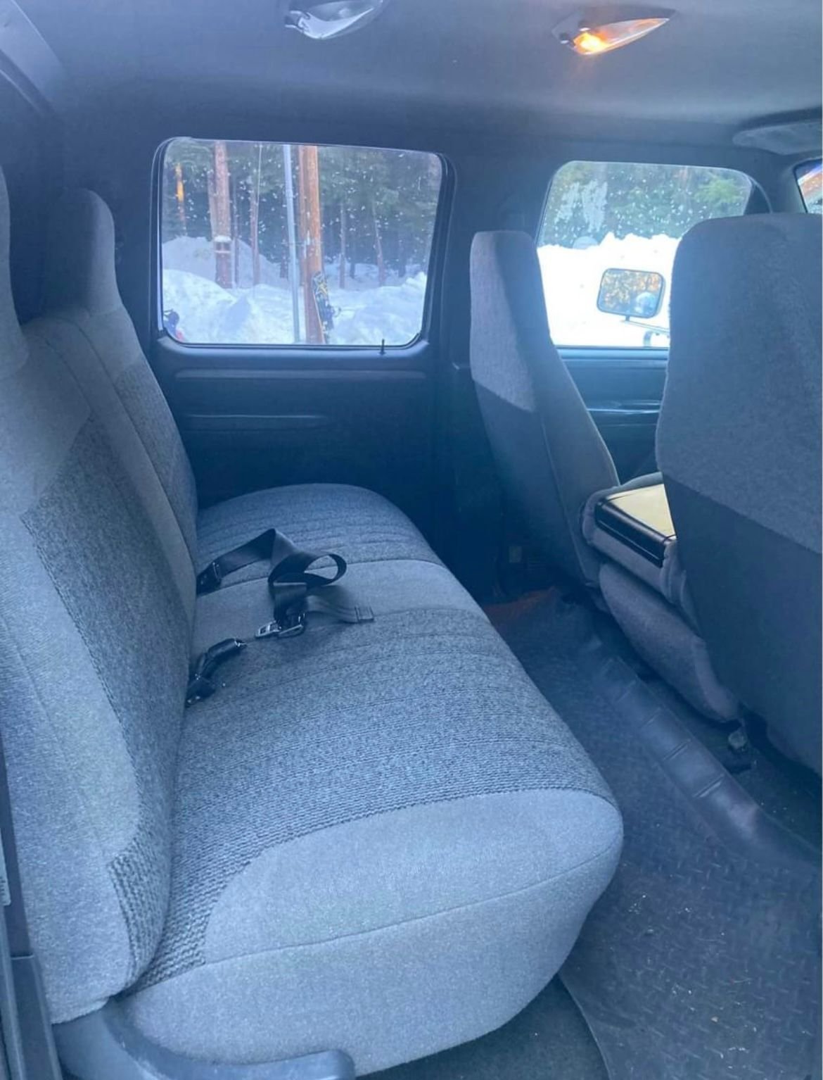

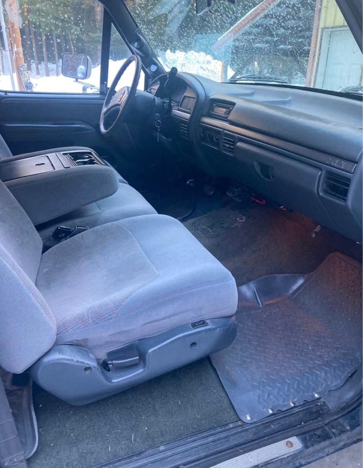

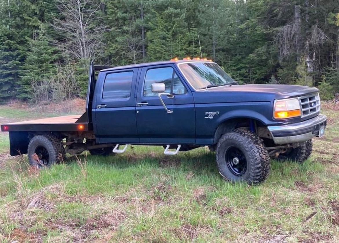

it’s getting cold here in north idaho, -35°F wind chills the next 2 days. don’t think i’ll be doing it for a bit though. thanks guys. i’ll attach some pics of the new truck! 😃

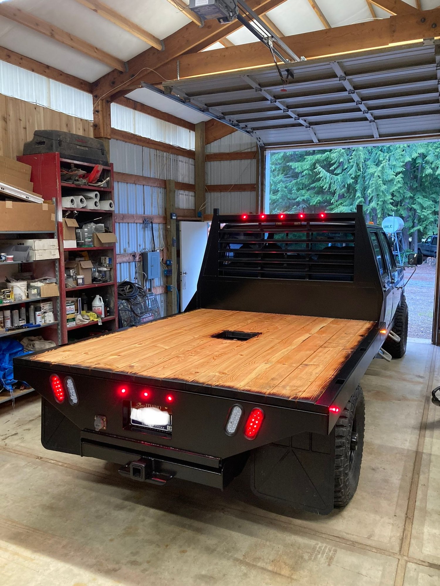

flatbed being made
flatbed complete. he did an amazing job on it

By the way that is a nice, clean truck.

Yes, clean ride!
