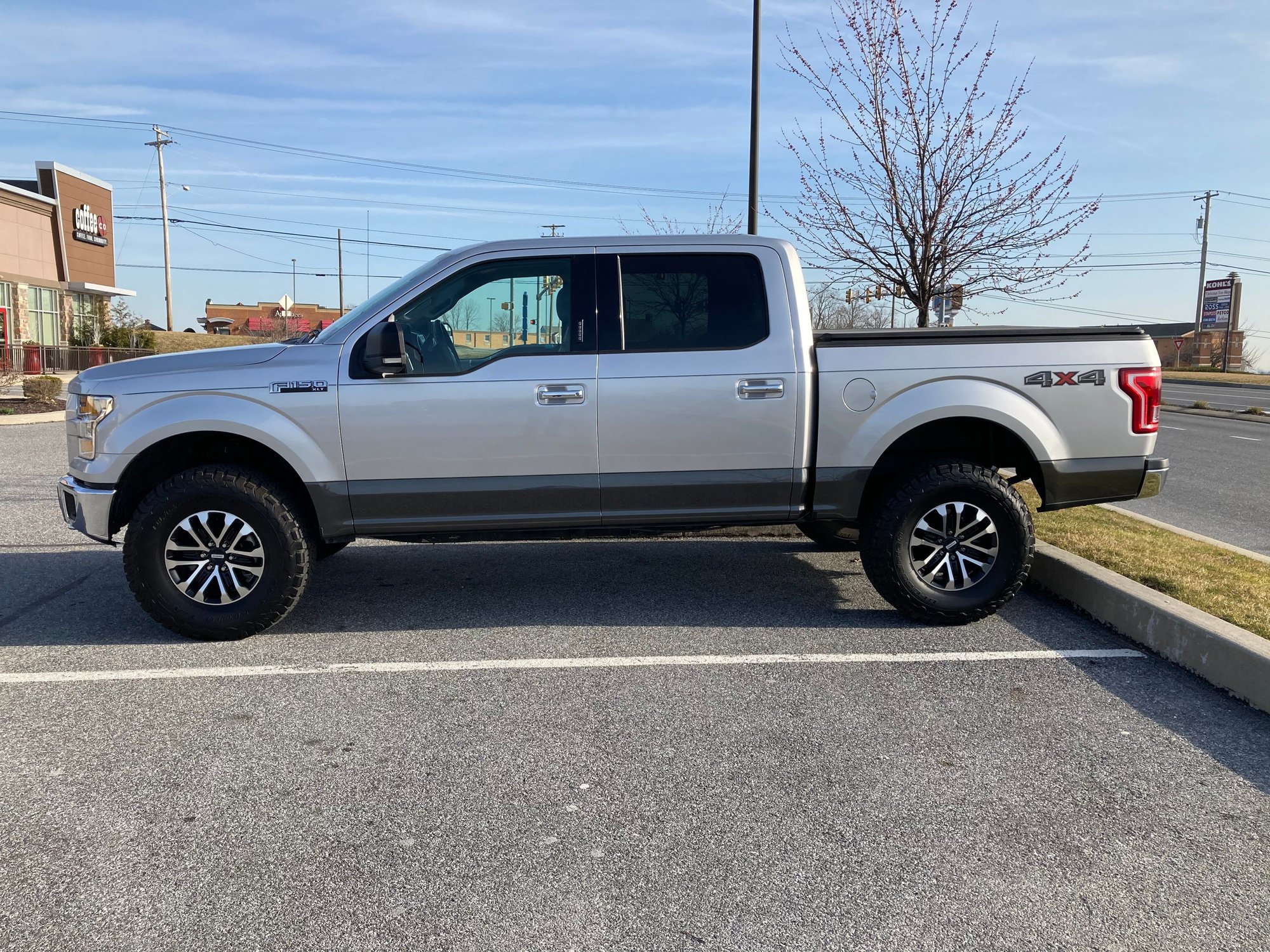

On my 2016 I did a 2.25” ready lift in the front and then removed the stock block in the back and replaced it with a 3” block…… then bolted on a set of Raptor take offs with BFG all terrains……
Old Dec 21, 2022 | 01:34 AM
shroom1's Avatar
shroom1
7th Gear
Joined: May 2015
Posts: 7
That is a great look
