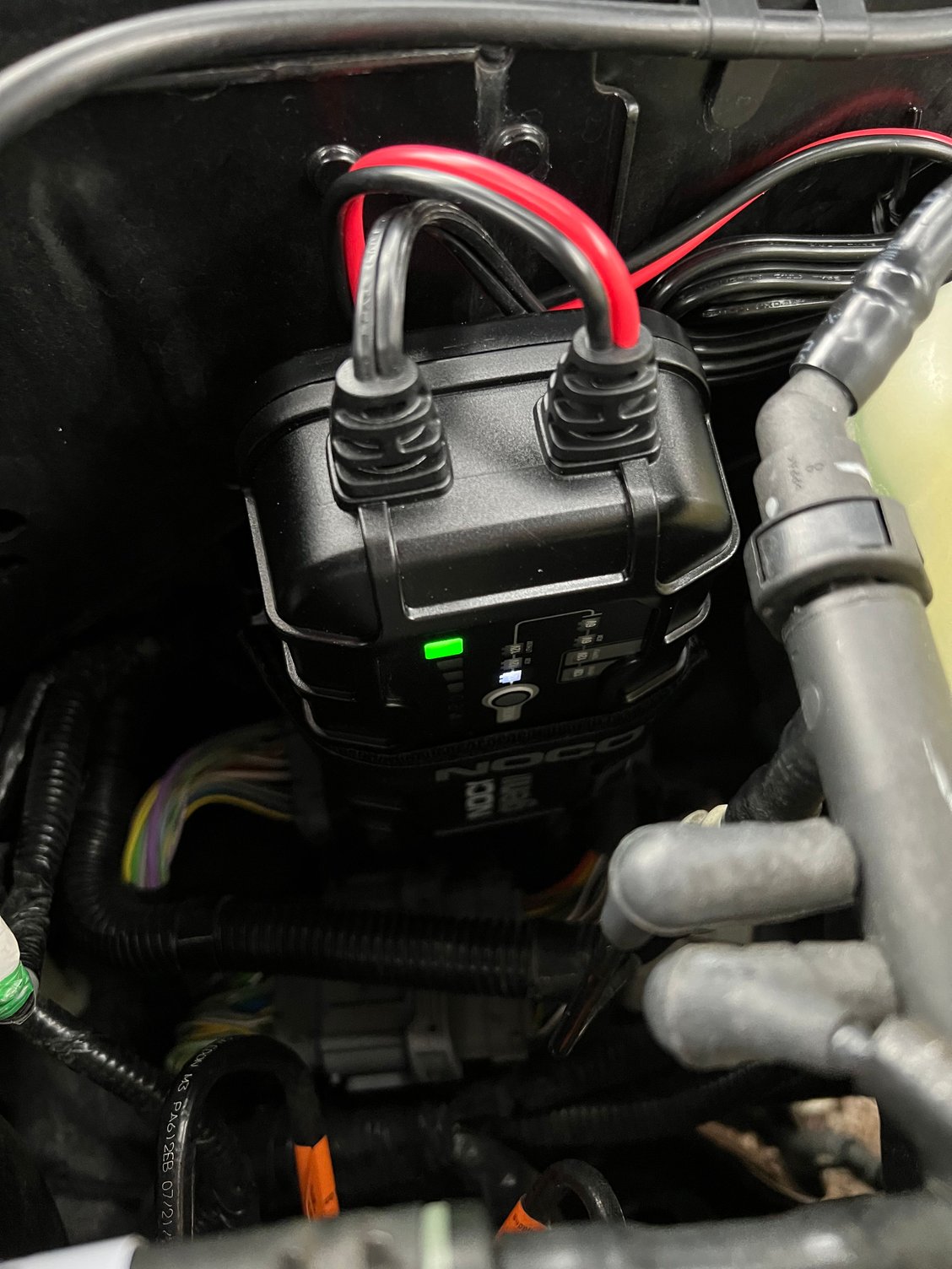

Originally Posted by chadstickpoindexter
And I finally got the bracket mounted so it’s not just sitting in an open spot under the hood!
That's the challenge I'm facing right now (even with the smaller NoCo); not a whole lot of space to attach a bracket. At least, over by the passenger side battery...
