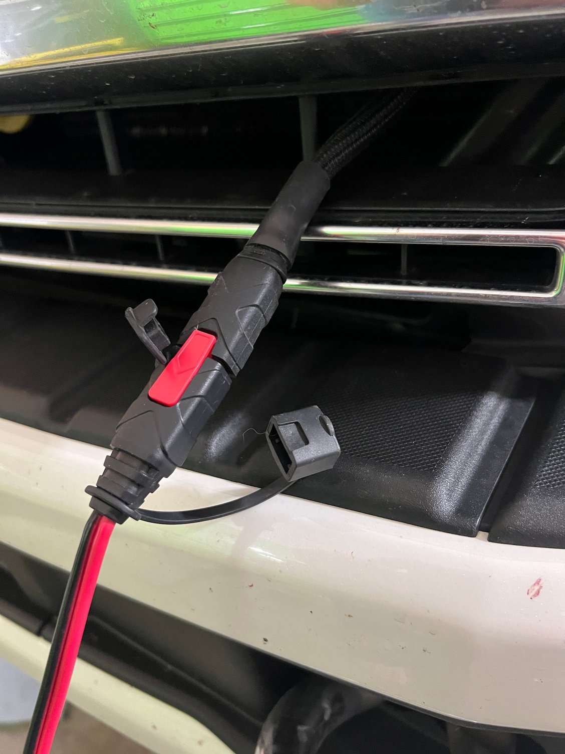

I added a stainless bolt to drivers side for my NOCO. The remote charger plug hides in grill. Old FD trick to remember shore power is to loop extension cord thru drivers door handle. I use a piece of paracord.
