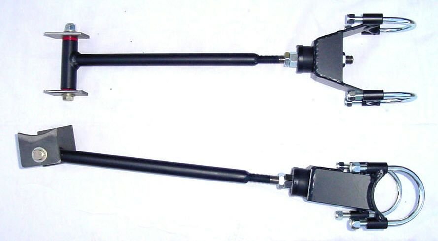

That may a member with the profile Landyot. His profile says he is from VA. He started off buying an Ex and was dissatisfied with his rear suspension. He went through several homemade kits he built until he got one that made him feel better about his rear suspension. Several members asked him to make a kit for them which he did.

Those are radius rods. I had 2 sets and felt like they help tracking when I hit bumps.

How about a picture? I don’t recall the Landyot Radius Rods having any U-joints on them. I remember them clamping to the rear axle housing and having a poly bushing at the front mounting point. Could they be some other product that uses a Universal Joint, typically U-joints are only seen on driveshafts and axle knuckles……..?
EDIT: I finished my coffee and realized that you might have meant the U-bolts that hold the Radius Rods to the rear axle, that now makes sense to me. Good news is that @Landyot isn’t long gone, he did last visit the site on 11-13-2021, hopefully he will get this ping and hop in to help you out. If not and you have the original U-bolts maybe you could provide the measurements and the group can help find the correct replacements. Pictures always help.

Glad to hear I haven't been forgotten. I no longer build the radius-rods and do not have any U-bolts on hand anymore. They were standard 1/2" thread U-bolts measuring 3-1/2" between the legs. Some sellers may call them 3" U-bolts since they fit around 3" NPS pipe ... and 3" pipe measures 3-1/2" O.D.
The current builder has had them listed on eBay. Search there for a user named landyotsales ...
https://www.ebay.com/itm/195169555603
https://www.ebay.com/usr/landyotsale...p2047675.l2559
EDIT TO ADD: I ASSUME you're talking about the U-bolts which wrap around the axle tube and NOT the square U-bolt that went around the leaf springs on the very early kits.

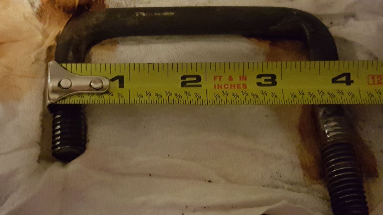

Well, two things. First, Fastenex is impossible to deal with and their web site does not let you buy those u-bolts. Second, that was actually a good thing. I managed to get the one remaining u-bolt, and low and behold, it is a square one! So I am guessing that I have the old style @Landyot ? I am attaching 3 pictures of the old one with a measuring tape. Seems the one leg got bent and the other leg was sheared off.
I have been searching now for literally a couple of hours to find a replacement. This is the best that I can find. It includes the nylock washers, too. What do you think? Are they a good replacement? Should I find something else?
This is not a cookie enabled link.
Amazon Amazon
I know they are longer than the original, but the thread does seem to go up far enough to still be workable. I am hoping the extra length will not interfere with anything. Do you remember if that is going to be a problem?
Thanks ever so much for all your help!

Dobermann ... I cannot view the Amazon link you sent, but I doubt that item will work because I had those square U-bolts custom made to my dimensions. Sending you a private message.
