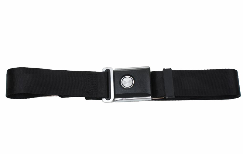

Although I'd prefer something with a Ford logo, I would even more prefer something oem for the bump years over the square starburst Ford style from 77+--It reminds me too much of the overstuffed Mercury Marquis my grandparents drove.
It's frustrating that seatbelts plus sells lap belts with a very similar buckle to OEM for 68-76 Broncos in the lap belt variety but doesn't have an option for those buckles for the 3-point belts.
https://www.seatbeltsplus.com/produc...ronco-Lap.html

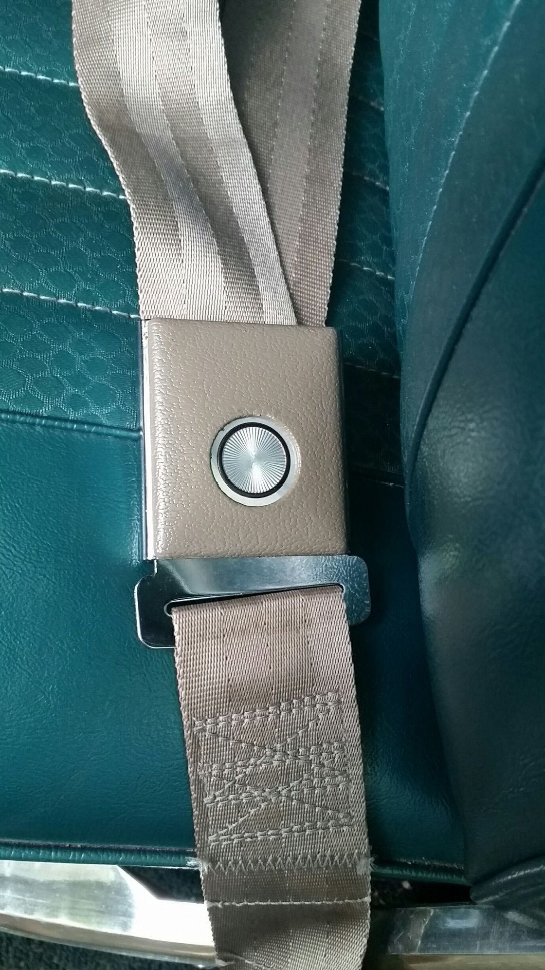

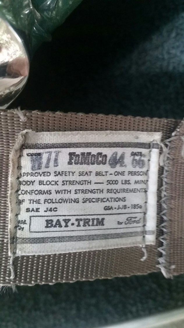

I am with you Steve on why the don't make the 3 point with the round Starburst.. I have lap belts with the Starburst in my 67 that seem to have been manufactured in 66.. Not sure why the colour didn't match the seat. They are in excellent shape, but not sure if after 55 years the stitching is up to snuff.
I think 66 is the manufacturing year
