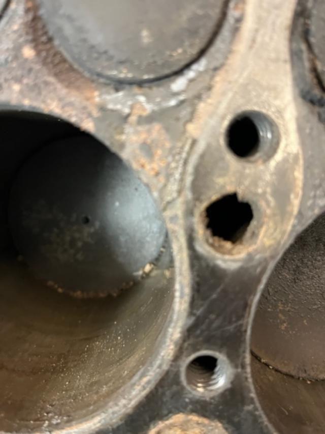

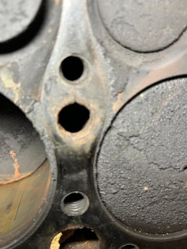

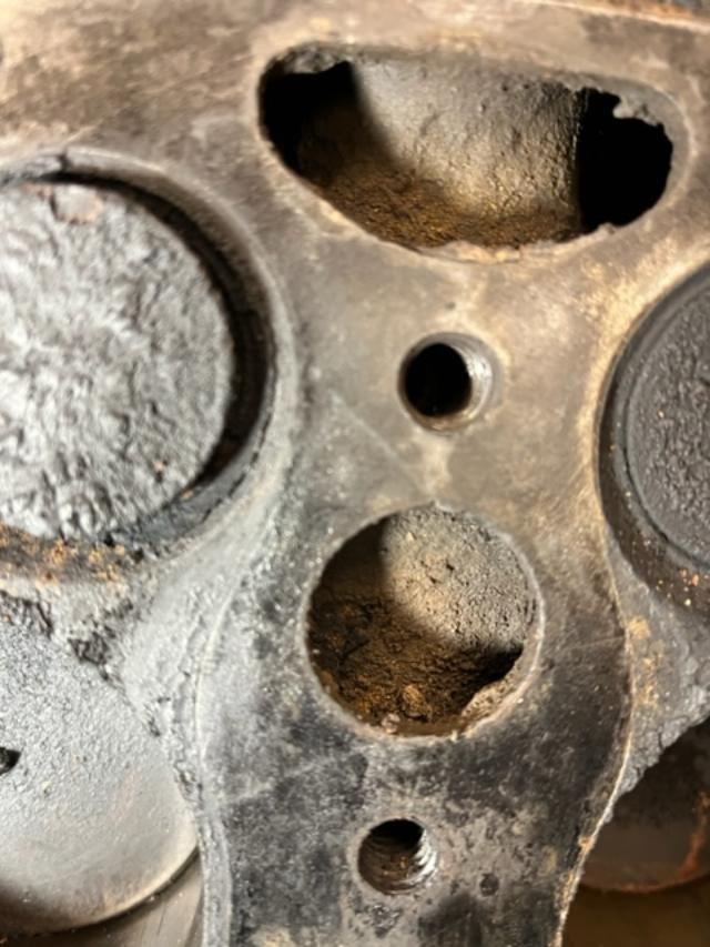

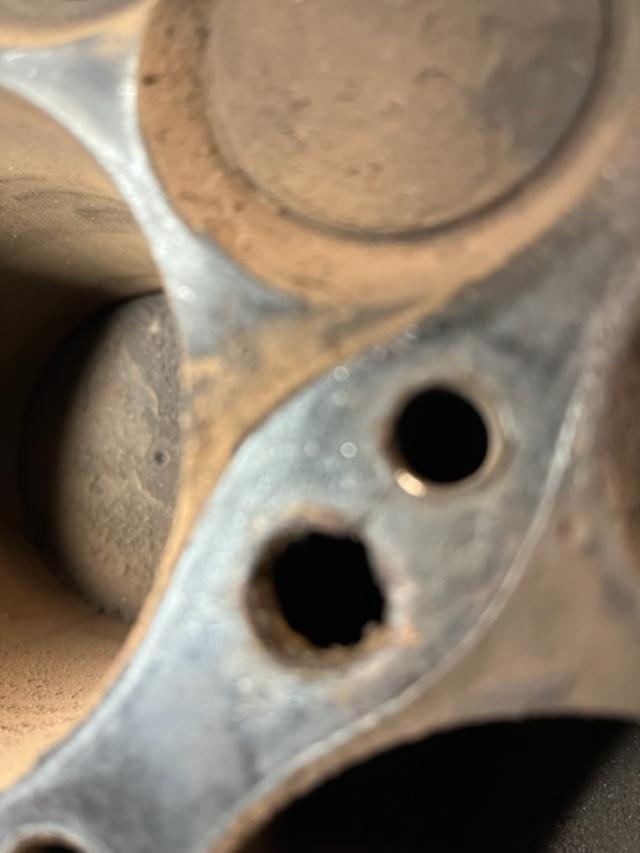

I know this has been posted before but cannot find posts. My block has the regular cracks between the head bolt and water jacket. Can I have them fixed ?
The pictures are not very clear but the cracks are the same as we have all seen.

Yes those are readily repaired. Just an FYI...Kelly's Block Welding has been around for decades (Kelly himself use to do my dad's engine work on his racing engines back in the 1940's!) The shop was passed down to Kelly's son Dennis who sold it to one of the machinists that worked for both of them!!!!!
12910 W Washington Blvd, Los Angeles, CA 90066
(310) 827-6795
They have welded up my aluminum cylinder heads, etc.!
Best work!!!!!!!!!!!!

Generally those cracks don't need to be fixed, providing they don't extend into the exhaust passage (for the center ones). My engine has similar cracks and has been running just fine for 17 yrs. When I had it rebuilt, I asked the machinist if he thought they were worth stitching, he said not to bother if they hadn't been leaking.

Agree with Ross, much ado 'bout nothin'
