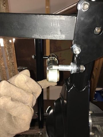

Can't help you on the front as I installed a CPP IFS(2" drop spindles) on my 51 but the rear is a TCI Parabolic leaf spring kit that only required removing the rivets on the spring perch mounts to remove and drilling 4 other holes, I did have an issue with their measurement for the upper shock bar mounting holes which I ended up drilling an inch and a quarter farther forward because the shocks were not lined up with the lower mounting points.
Other than that the kit lowered the truck nicely and is not a harsh ride

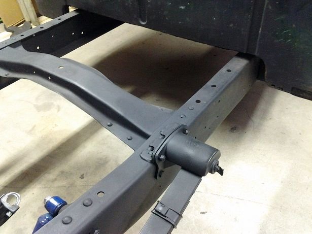

On the same subject and not to hijack the thread.........(I can start a new thread if I am butting in)
I'm sorry the picture is so big. Not sure how to get it to load in a smaller form.
My 54 has eight leafs on the rear axle. By removing one or more leafs, does that make the ride any smoother and less jerky or does it just lower the rear a bit?
How many and which ones should be removed? It looks like the three lowest leafs in the pack would be the easiest to remove. Would there be enough thread left on the
U bolts or would new bolts have to be installed?

rpaxton939....A well known f100 supplier told me to remove every other leaf...I had 10 leaves to start....I think there are now 5. Removing the leaves lowered it nicely and the result was a smooth ride. The load capacity is obviously reduced.... so I did add air bags for extra load capacity...they only have a couple psi in them to prevent total collapse of the bags and not enough pressure to raise the truck. When I hook a 16' trailer to it (yes I do haul a car once in a while), I bump the pressure up. However, the real drawback for me is a very noticeable axle wrap ...even without towing and with the flathead motor. If you are running a later V8 with more torque than the flatty, I think removing some longer leaves might leave you with axle wrap as well. You might be ok with just the bottom leaves removed. It should lower it by the thickness of the leaves removes. looks like you have enough threads left on the U-bolt you might can test it easily.
I worked my truck hard before restoring it....i had several cracked and bent leaves in the rear....I had to replace them.
