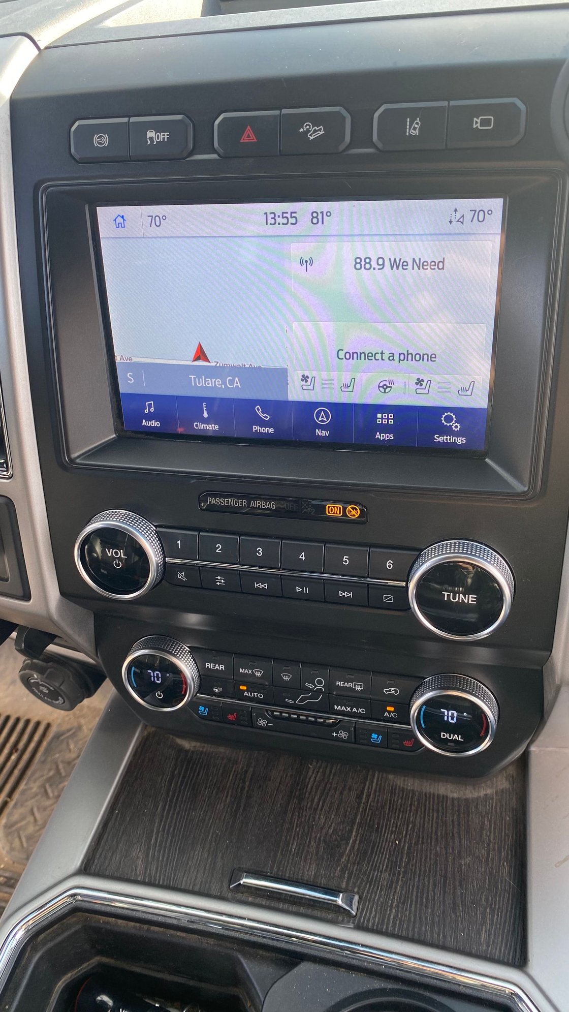

Decided to splurge a little. Found a 19 Expedition Front Panel on eBay at a good price.
Direct snap in, no programming required. Mine does not have CD. There are both types available.
EDIT: No CD option is available. The years for this panel are 2018-21. I have not confirmed 22.
Factory
Expedition dash (off)
Powered on
Wife loves it also

I was trying to determine the difference between the two images, so I reckon you got the CD now?

I like the display off button on the expedition bezel. This is a solid upgrade all things considered. Even the plastic surrounding the screen makes more sense on the expedition bezel.
I guess the only button that does not function is the "rear" button?
If so, that'd be nice, as I haven't bothered to copy all my CD's to memory sticks for my '20 (who has the time these days?). Sure would be nice to have a CD player, for me that is.
Can you post the fleaBay link, or is that verboten?
No CD. Here is the link Expedition Front Panel (Not what I paid)
If you look at the lower part of the panel the HVAC controls are different. It also has heated steering wheel hard button and temp settings on the dials.

Exactly, I think it looks cleaner, maybe not for everyone, but....
Now to find one that fits her 18 F150 !!!!
May have to remove CD to make work.

Awesome. It is a super easy swap. (4) screws and R&R the top buttons. Good time to add hill decent (FX4) if you dont have it. lol
You press the button it "turns on" and dash switches to HVAC rear screen.
