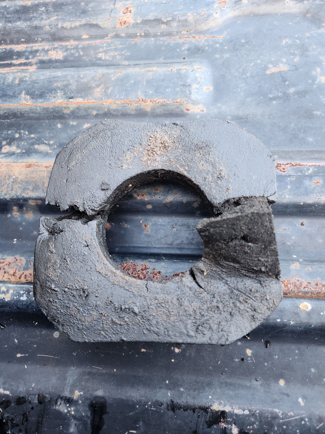

Can anyone identify this part that fell of the underside of my 1980 F-150 after a trip to the car wash to clean the underside. It is foam rubber 5 1/2 in by 5 1/2 in by 2 in thick. It has a 2 in diameter hole in the middle.

You have a manual transmission by chance?
It looks like the part the fits around the stick tower befoure the pan is bolted down.
Kinda like a seal to keep fumes coming in around the tower & pan.

Yes 4 speed manual transmission. Will look and check your suggestion... thanks for the reply

Your are correct, looks like it fits up there, now just to find a a replacement... thanks again for the help... just starting a long slow restoration of this great truck.
Same piece on my truck, exactly as described by Dave.

Neither of my trucks had that part I only know of it as it came with a NP435 trans I bought used for my truck.
It was in pretty bad shape so I did not install it.
I also did not try and look for a replacement so if you find something post up where you got it.
BTW I don't get any smells from not having it.
I have carpet and rubber shifter boots.

Mine had deteriorated and would fall apart if you touched it so I just removed it. The condition was the same with ones I came across in the JY's.
I ended up using the dense foam from "still good" part of a worn out truck seat, after cutting it down to size (actually I made it a little bigger and taller than the original piece and tapered it some to fit up into the base of the shifter boot a bit). It has held up well so far . It's also easy and cheap to replace whenever the time comes but I doubt it will any time soon

yup, thanks to all who responded... looks like i will be hunting up some dense rubber foam...

I went to the transmission shop and they said they see this all the time, can never find replacements, so they make their own. I found this kneeling pad at Ace Hardware, it is the right consistency high density foam and it is
  • Washable, resists industrial chemicals, oil and grease
  • Will not mold and mildew if stored wet
So I got one and cut out two pieces and glued them together, and I think this will stuff down in there just fine....

Thanks for the update but for me to now put that in place I would have to pull the rug up and that may take pulling the seat and then the pan.
I think I am good the way it is but if I ever pull it apart I now know what I can use.
