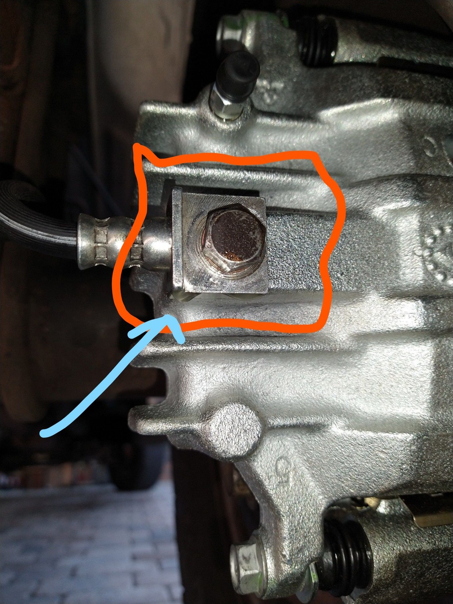

Here is the pix of the Right Rear Caliper. The blue arrow shows that small drop of brake fluid. Crush washers are on both sides of the banjo bolt. Do I need to change to a different size washer? I compared previous versus new washer and could swear I choose correctly.

First, how thick were the washers? Cheap lines can come with .030" and you want .060"
The thin ones have ALWAYS leaked for me.
SUR&R sells a nice assortment of quality, thick copper washers.
I'm not saying this is your problem, only that it's the first thing I'd look at.
I've never known a torque spec for banjo bolts. For me it's always been so-it-doesn't-leak.

Well I can't tell for sure, but are you sure you have that flex hose on the correct side? I did that this past summer, I couldn't stop it from leaking went through 2 sets of washers, then I realized I had the darn block flipped over. Flipped it around and not more leaks. Felt kind of stupid, but I had two other look at it and they didn't see it either....LOL

I'll take a pix of my left side tomorrow and it will show the same position that the right one is seated. I thought of that too, but on a closer look there is a metal mold that would impede the brake hose from seating properly. I will start at replacing the new crush washers with a thicker pair.

Here is the Left Rear Caliper. The Flex hose is positioned so that the "L" shape is facing away from the caliper. It's been on there a while so I know the positioning is correct.
