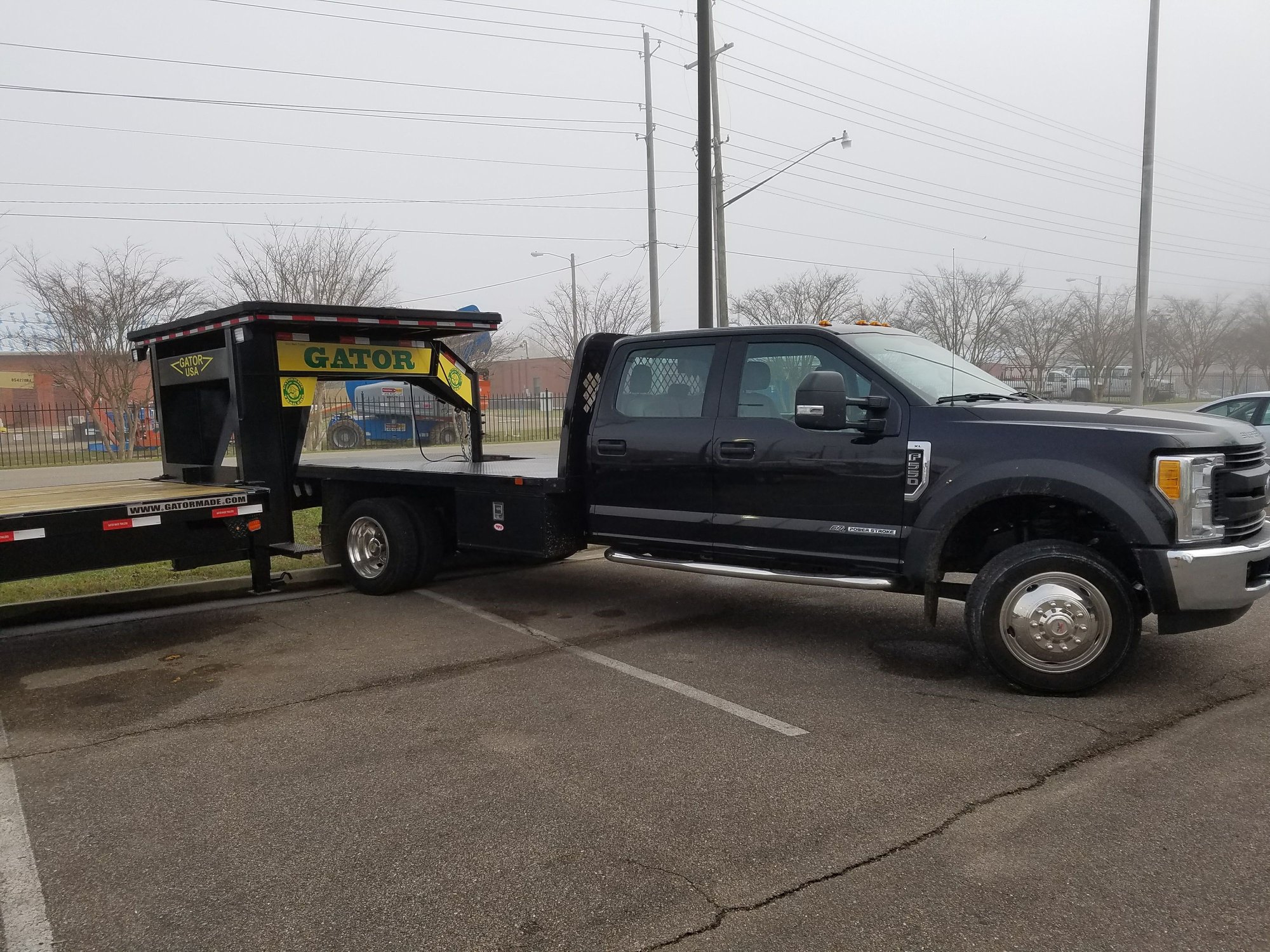

My 2017 F550 is losing oil, alot. It has been for months. About a gallon every couple thousand miles. It's right about the 300K mark
Little background, from 2017 til 2021 I put on about 225K towing 80% of the time. I have a small fleet of trailers ranging from fully loaded 16k bumper pulls to 40K gooseneck trailers. She doesn't run lite very often. The 300K number is almost irrelevant. My travels have be at days at a time transmission and oil temperatures at 240F traveling across the USA. Similar to a hotshot but I'm all company owned equipment.
Anyways, early this year, Ford quote me 13,000K to lift the cab, pull the motor, reseal the engine, new exhaust studs plus a couple of other minor things. I past on it.
This past hurricane season was tough on the old girl. I would start in the morning and not shut it off till the evening most days. The engine has about 10,000 hours, going on 4000 idle hours. She runs great. Just before Thanksgiving, it was a cold morning in West Memphis, I started it up and there was one heck of a racket coming from the bell housing. Sound like a torque converter had drain down overnight. Never once have I ever had a transmission concern. I was loaded at 45,000 lb. Made it home that day, Turkey was okay, that I brought her to work. Each morning that I've started it around Thanksgiving it's been rattling really bad in the cold mornings Clears up after a few minutes. I'm just returning back from Florida with another run on a different 550.
She's been a great truck, My biggest problem has been the fuel tank collapsing three times. I've replaced the brakes once, tires four times, regular maintenance every 7500 and 15,000. Never once had a problem with the emissions, did have a intercooler break and she's been hit twice with minor cosmetic damage. Heaviest load was 56K.
She has been a great truck absolutely great.
Now face with the dilemma of sticking 20,000+ into chassis or 80+ into a new truck.
I really don't want a new 550, and this is coming from a guy who buys a new personal vehicle every year sometimes months apart.
What would you do?
She been towing since she had 200 miles on her
