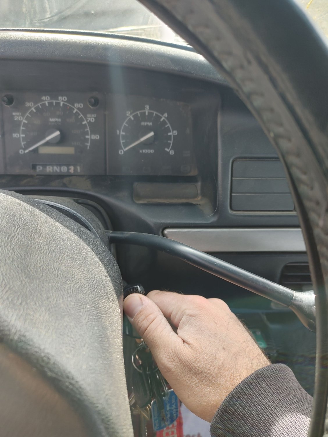

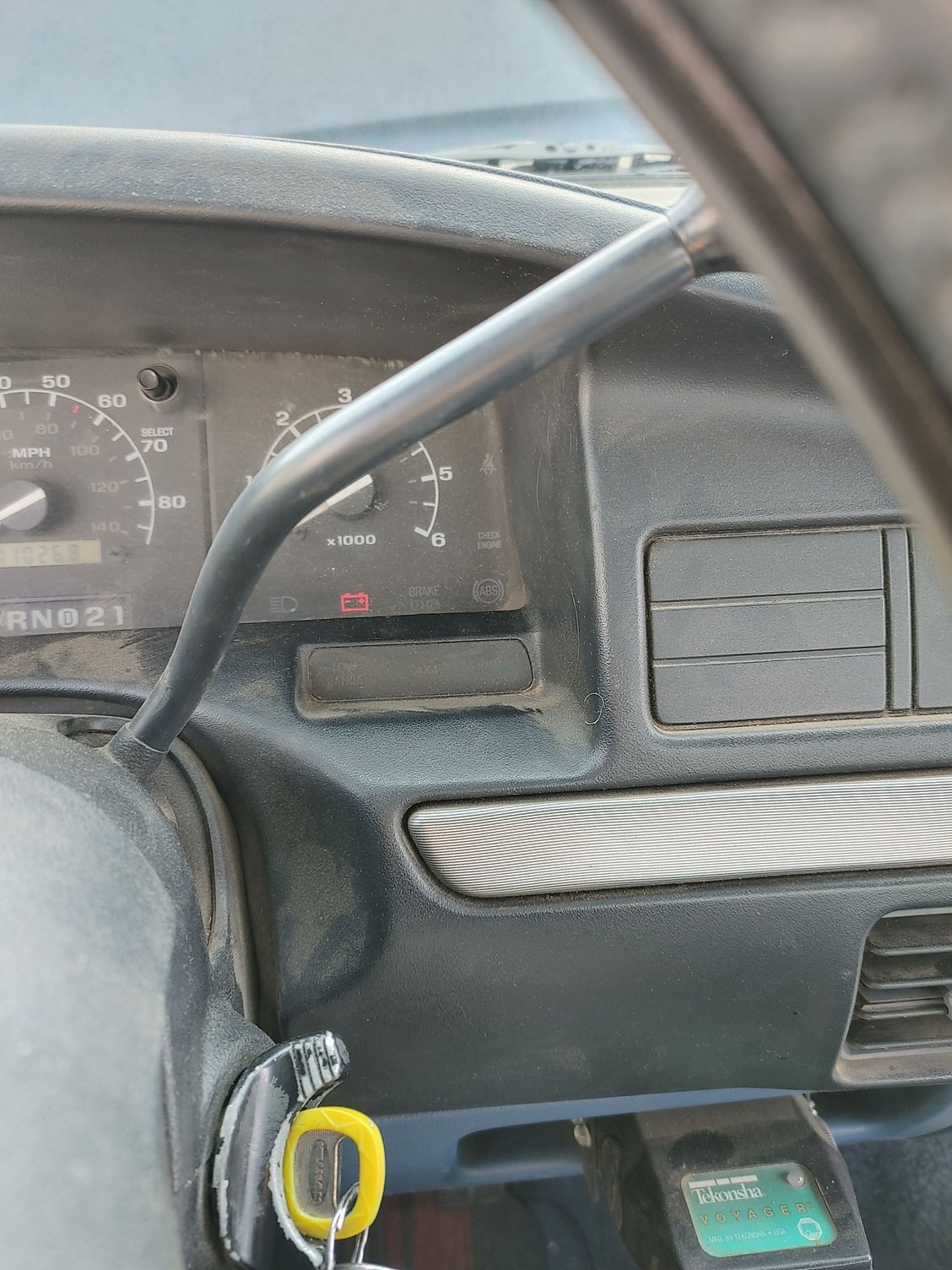

I haven't been able to do much with it in a while, but I did get a new PCM for it today and swapped it out, hoping that might help. Unfortunately, it did not. Here is a short video of the tach. Hopefully it will post on here. If it doesn't, the tach will for example go from 2,000 down to 500 RPMS randomly.

Video clip

Ask your mechanic if he removed the spout when he timed it. If he didn't then it needs to be removed and timed again. If he ask tell him the SPOUT removes spark from the computer to set base timing at 10 degrees BTDC. When that is done and the spout replaced the computer takes over the timing for how it's programmed. A lot of mechanics don't know to remove the spout.
