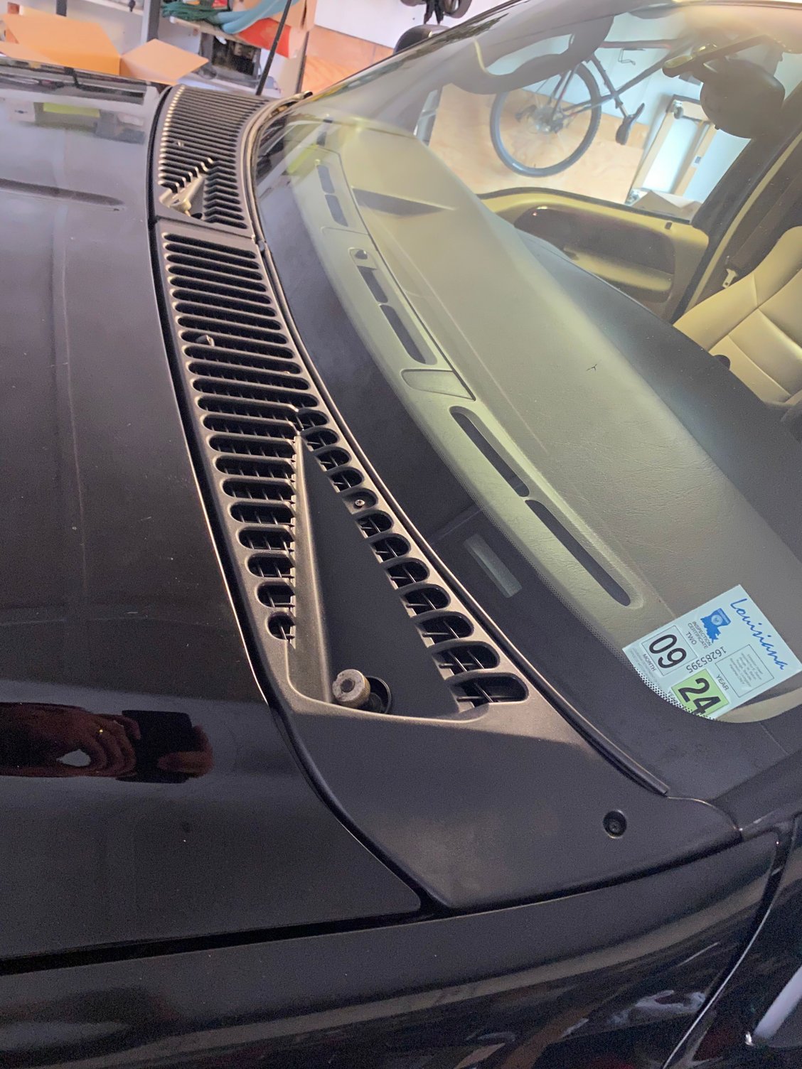

My brand new complete cowl came in yesterday. Any tips on the install? Seems like it could be fiddly.
i’ll start with the wiper arms, does the nut cover slide off or does it lift off straight up? I don’t want to break them.

I got the wiper arms off with no problem. Never seen that type before. Way easier than other OEM’s. I’m actually already done replacing the cowl. Went pretty smooth. Instead of removing the hood, I just closed it halfway and held it in place with one arm, then used the other hand to work the cowl in place. Pretty easy job if you take your time and don’t force anything. Make sure before you tighten screws on top that the little plastic screw holes are lined up. I used a small jewelers screwdriver to line them up. Take a pic of the weather stripping b/t cowl and windshield before you remove it so you know how the new one goes on. Other than that it was pretty easy. Going to paint the wiper arms flat black while I have them off.

I’ll add a few more bits on the job.
This is delicate plastic your working with in addition to 20 yr old plastic you are trying to fasten it to.
DON’T FORCE ANYTHING!!!!!!
If something isn’t feeling right or going together, STOP and assess. You will break your new cowl if you try to impose your will on it.
I got some info from this video. https://m.youtube.com/watch?v=LpXMbd2DuQo
You do not have to remove antenna. Just drop the passenger cowl down on top of it. If your antenna base is loose, the is a great time to fix it using slightly larger screws in same holes.
You have to pry about 6 plastic “Christmas Tree” fasteners, may want to order some. Possible to reuse old ones, but I used new ones.
Big fat weather strip under hood you reuse.
When putting new washer hose on the driver side sprayer, put a hand on the top side and hold the nozzle in place. When you press the hose on the inlet, it wants to try and go through the cowl.
