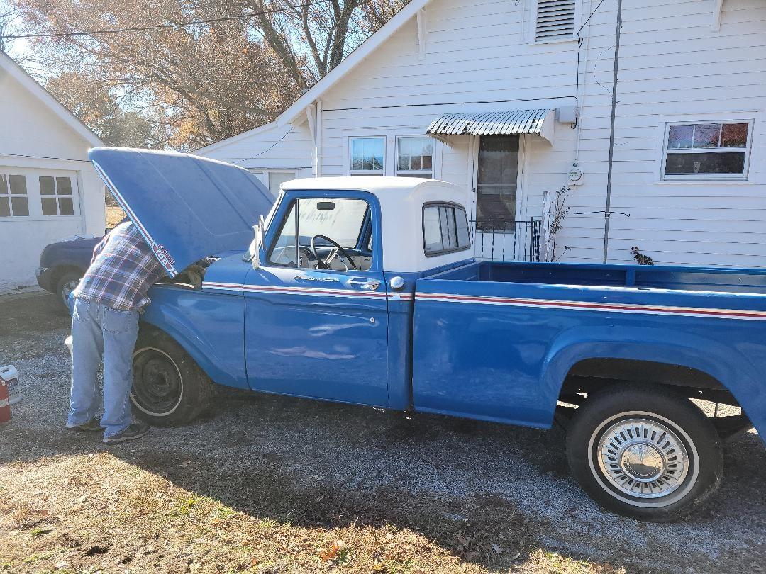

I got Dad's old truck out of storage today, and made some progress in getting it back on the road.
As i mentioned in an earlier post, it had not ran much in the last 10 years, because of Dad's failing heath, and not at all since May of 2016.
We pulled the plugs and put some oil in the cylinders and rolled it over, a little. Put all the plugs back in and after adding a little coolant, and checking the oil, we primed the carburetor, and it fired right up.
So far no issues with the engine, and the clutch was not stuck, but it has no brakes, at all, so I began the work on getting them working.
So far, the above work, a new master cylinder, installed, and moved into the shop was all I got done today. So tomorrow I will begin the task of getting the wheels off and looking into what needs replaced in there, to repair the brakes.
I know you all like pictures, so I took a few today. Please excuse the dirty condition of the truck, as its not been cleaned up yet.
More to come as we move forward on this adventure.

I had a pretty good day in the shop today, with success for the most part, with the exception of a few small hiccups.
As expected the brakes were in horrible condition, and all needed attention desperately. I got the rear brakes all cleaned up and fixed up with new cylinders, and shoes.
It was getting late, but I started the right front, and got most of of it cleaned up and put back together, and the bearings packed.
After Church tomorrow, I will probably work on the other side, and then bleed the front, and of all goes well, maybe a test drive.
I blew out all the lines and since most of the system is new, and I am converting it over to Dot 5 fluid, in hope of getting rid of the Hydroscopic effects of the old Dot 3 stuff.

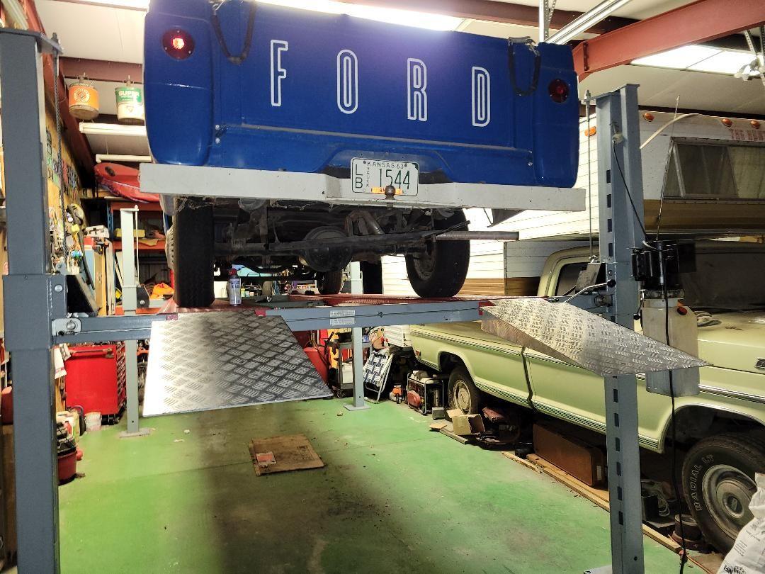

The Yellowish truck is a 69, and has been mine, since 1981, my senior year of high school. It is mostly original, with the exception of rebuilding the C-6, and a rebuilt 390, replacing the tired 360, in 1989, when it had about 120 K miles.
The camper is a 1968, but not original to the truck. My wife and I purchased the camper in 1991 and we used it to travel, until 2007, logging about 30,000 miles, before we updated to a 5th wheel and and Super duty crew cab.
I parked it there, in 2007, and its been sitting on 8 screw type jacks, to keep the weight off the springs, ever since. I hope to get the camper removed soon, and then return it to light duty, and have some fun with it.
It was never really enough truck for the size of the camper, with its biggest limitation being the brakes. We were lucky enough, and careful with it, and were rewarded with good service, and several trips with almost no problems.

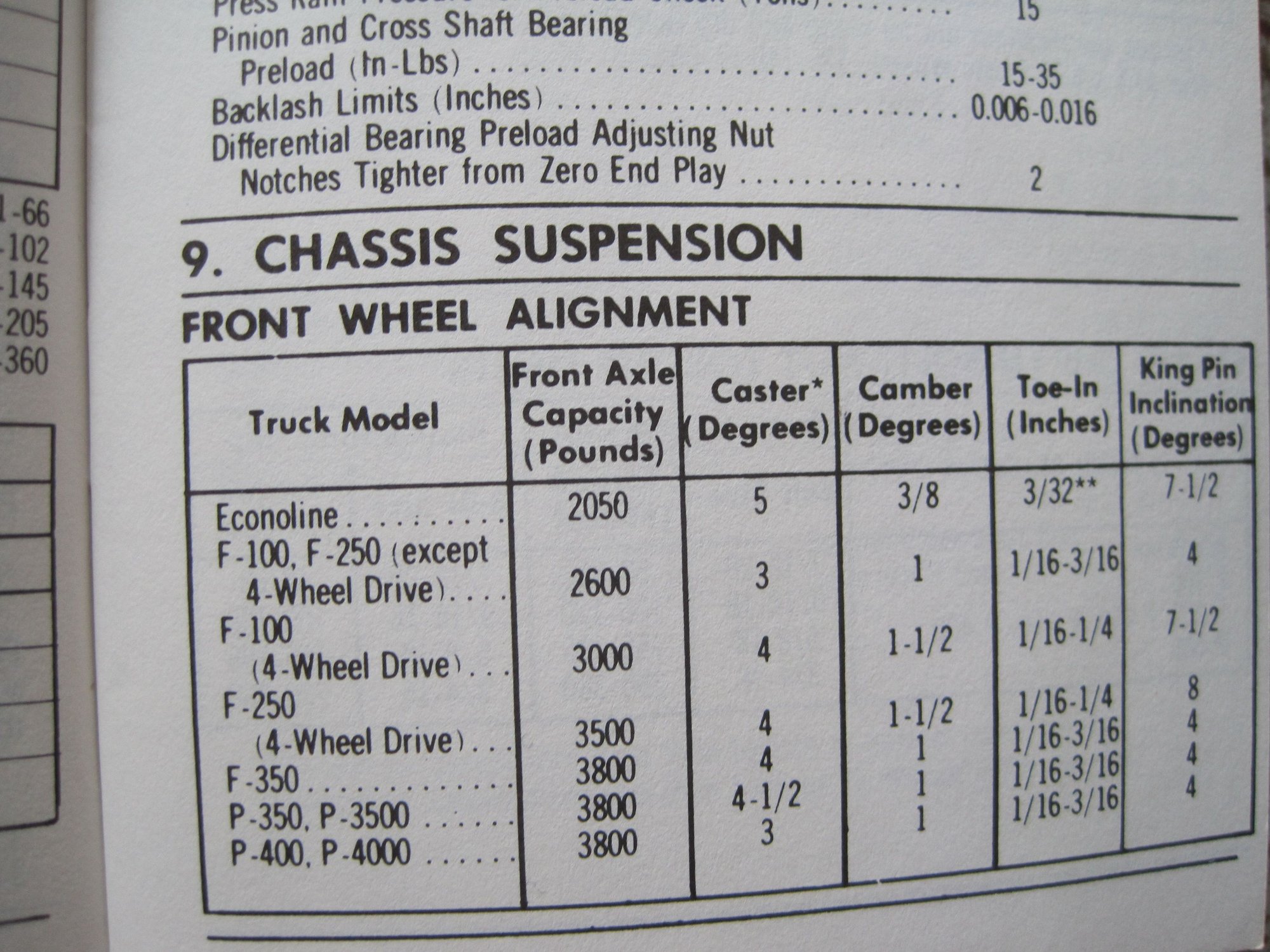

Second the left tie rod end is pretty worn out. I am sure that I checked it, years ago, but it is sure loose now.
Should be an easy fix, so I suppose I will order both and replace them, and reset the toe in. I suppose 1/8 inch or so of toe in is about right?
Third is and most worrisome is there is some looseness in the left king pin.
The weird part is that 30 years ago, when I rebuilt the truck, I replaced these with new brass bushing, and a friend's Dad resized them to fit perfectly. It has only been driven about 11,000 miles, and my Dad always greased everything.
So, I am very vexed as to why the looseness, has returned?
Does anyone know if the axle its self has bushing where the pin goes through?
It would seem, like that would be unnecessary, as the pin is secured in the axle and the part that pivots is where the bushing are at. I am just dumbfounded as to why this has became loose again?
Fourth For some reason the truck sits lower on the right, by about 2 inches, than it is on the left. This is another new problem that I dont remember the truck having when I was last around it. Its an easy fix, or should be, but will require the removal of the spring pack and re-arching of the springs.
The front is probably sagged down some from the 60 years of service. I am not sure what the exact ride height is suppose to be, so if some one has one that is correct, and don't mind measuring the bumper to ground distance, I would be grateful.
