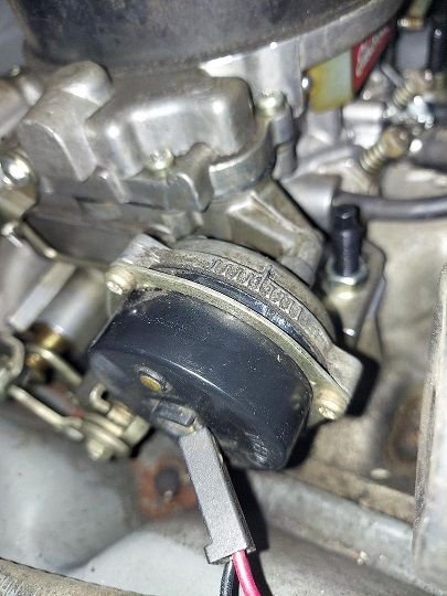

That is your fast idle cam. If you grab the choke door on top and move it back and forth, it moves that piece you are worried about correct? That makes the engine fast idle when the choke is activated. When the choke is off, that piece "flops" out of the way and the carb goes to base idle. Do you have another screw somewhere that holds the throttle? Usually there is a base idle screw and a fast idle screw. You are learning about this fast.

How about the setting on the electric choke? It seems to make the choke plate pretty closed and seems firmly in place when cold. (pic below)

  1. Got idle sounding good (figured out the idle screws)... even at start-up with the choke plate at closed position (adjusted electric choke as suggested),
