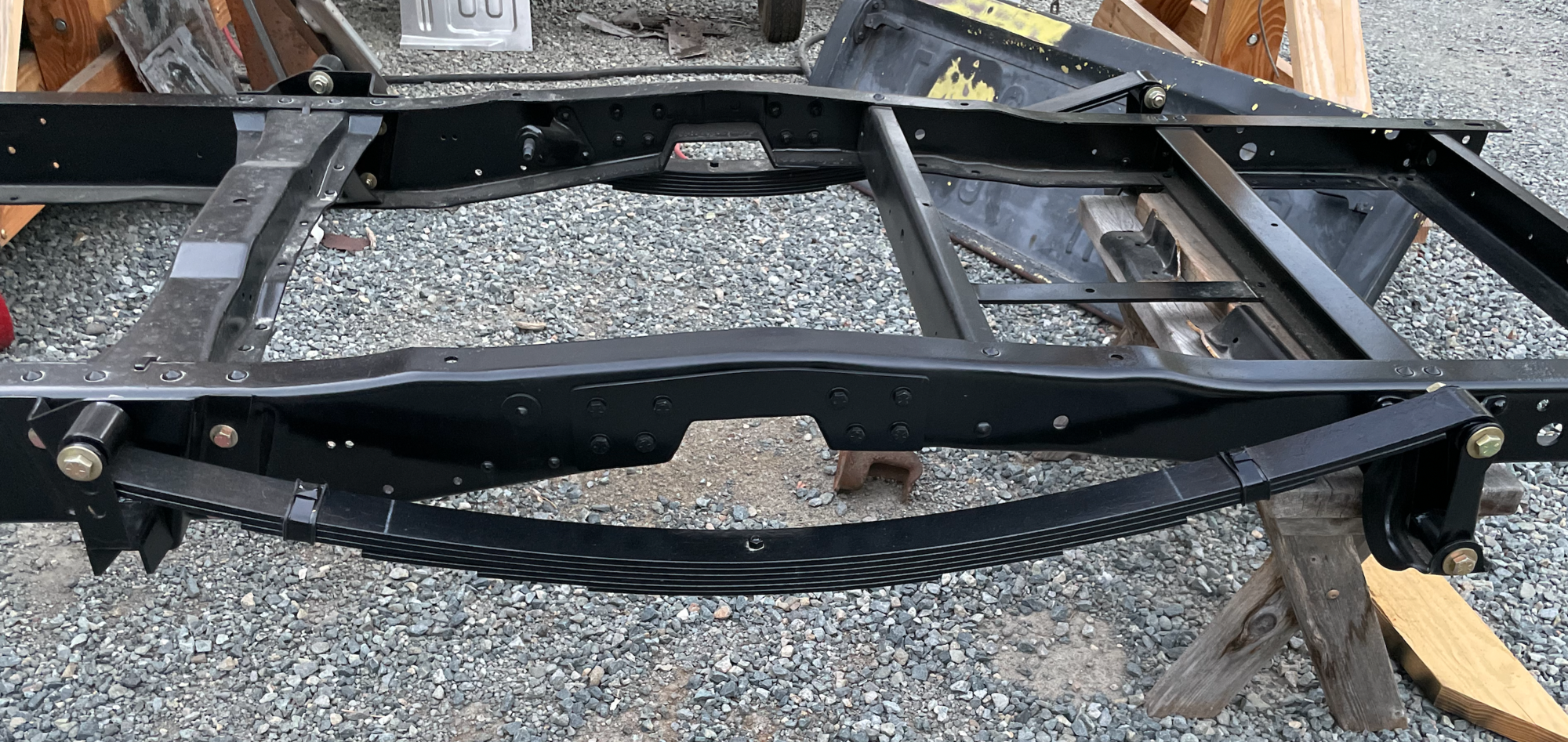

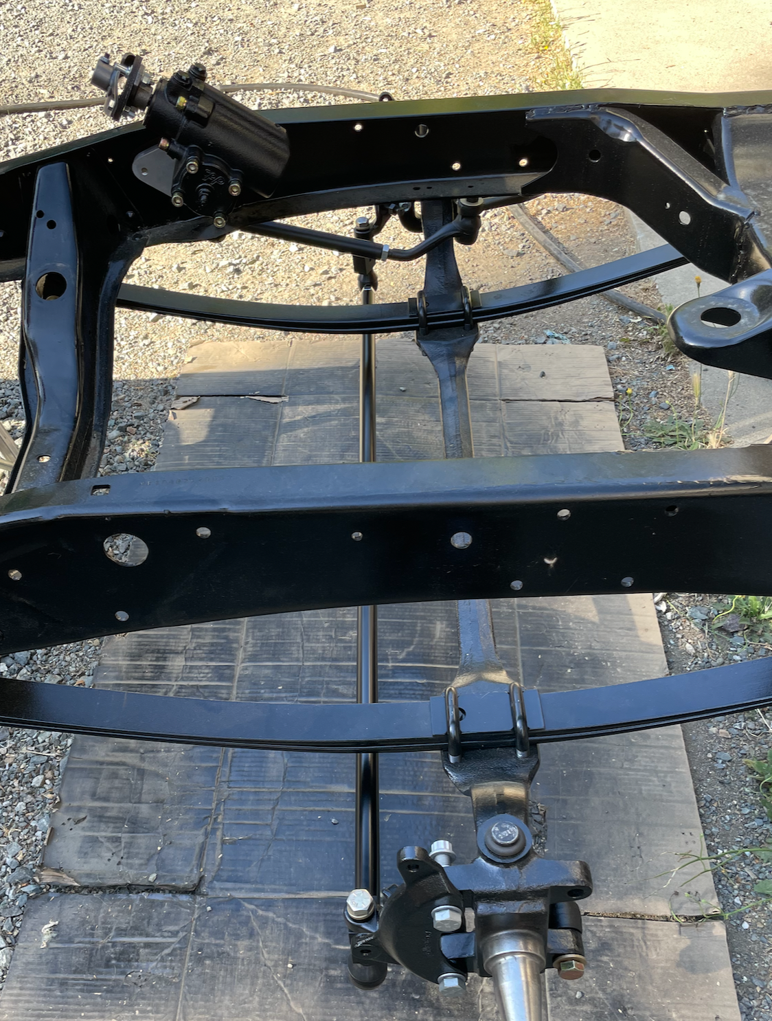

Here is a shot where you can see how far I moved the axle... it was actually 1.25"... I added that short plate so that the bolt through the springs did not conflict with the u bolts. I also used Sid's hangars and shackles and c notch on the rear...I trimmed the hangars a bit to be flush to the top of the frame. Not sure if I will flip the axle yet or not. At least I will have clearance if I decide to. Wilwood discs on front and rear....

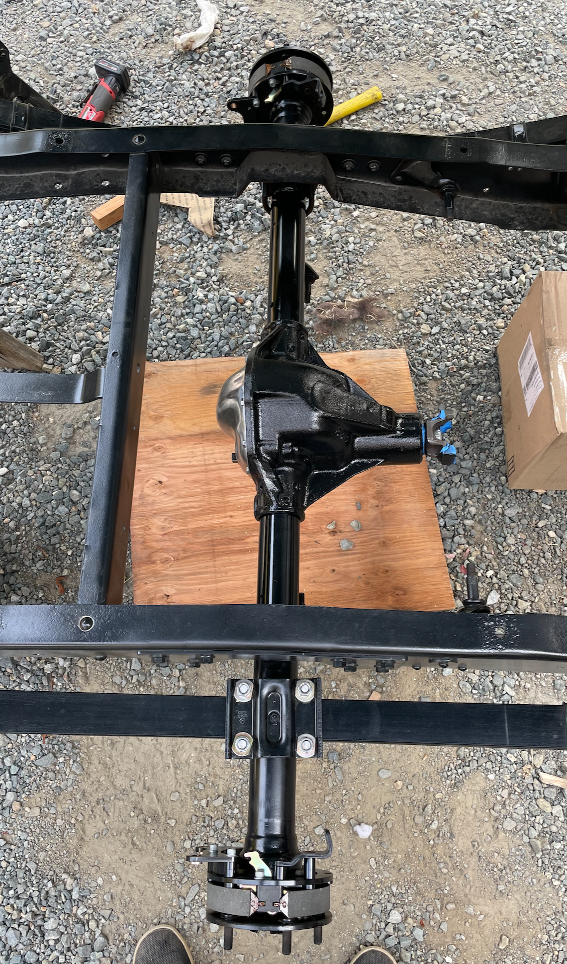

Yeah I notched the rear too, and had to trim their spring hangers. They crash into the torque box if you don’t. Here’s a shot of it back together on the old leaves which were totally shot and the bushings in em’. I think this is lower than what it will be with the Posies. I had the rear leaves in the very top hole, and it looks like the thing is a little nose high or level so I’ll probably go to the 2nd hole.
