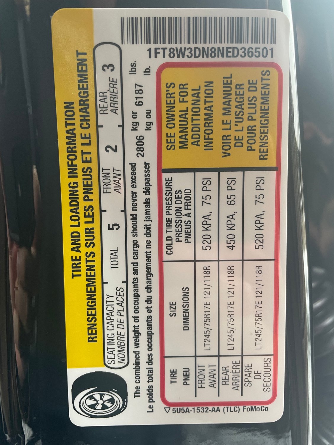

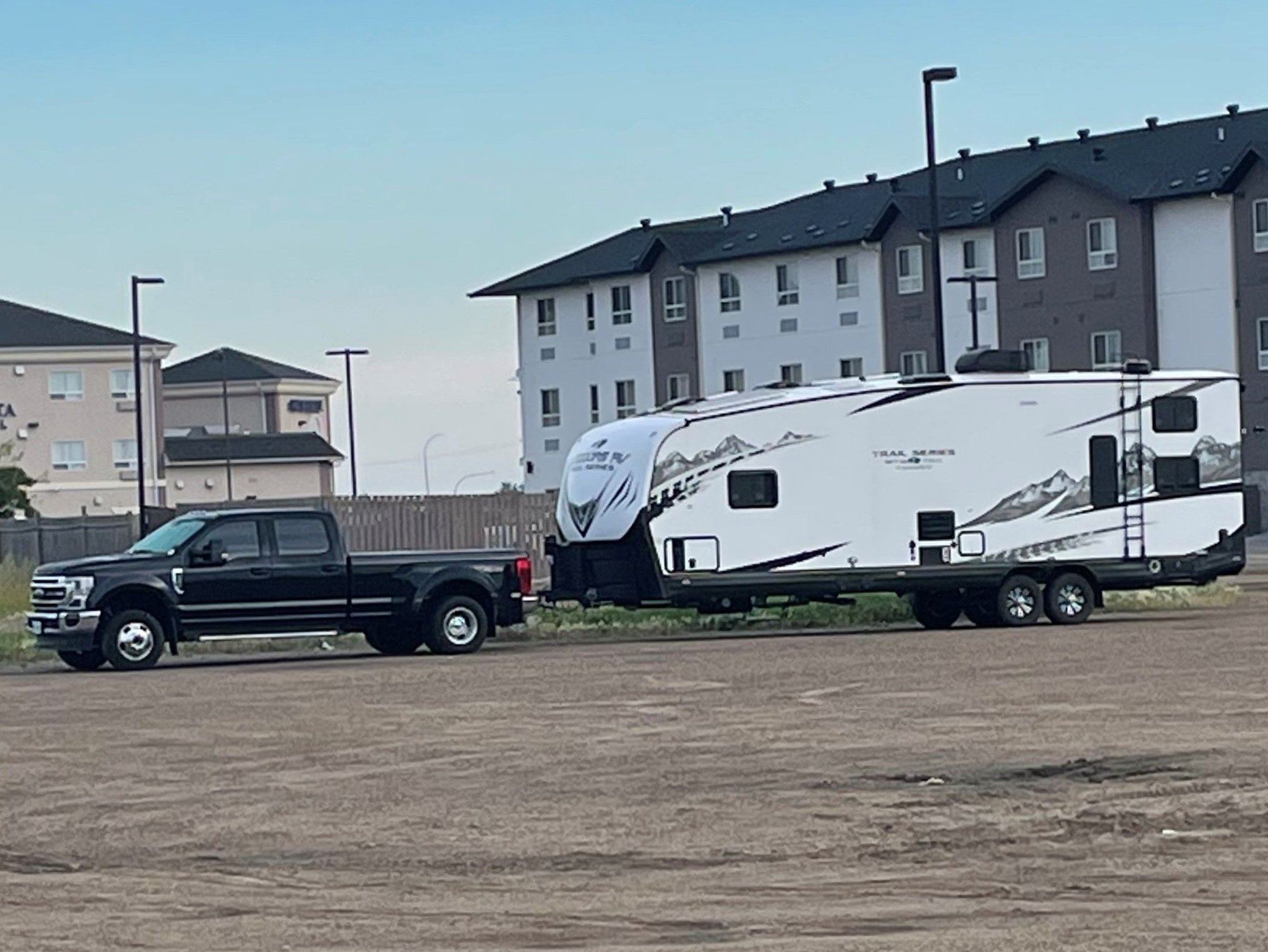

Yep, the 7.3/4.30 combo pulls this 14k bumper pull with ease, even in the mountains, and the 6200 lb's of payload is a bonus.
