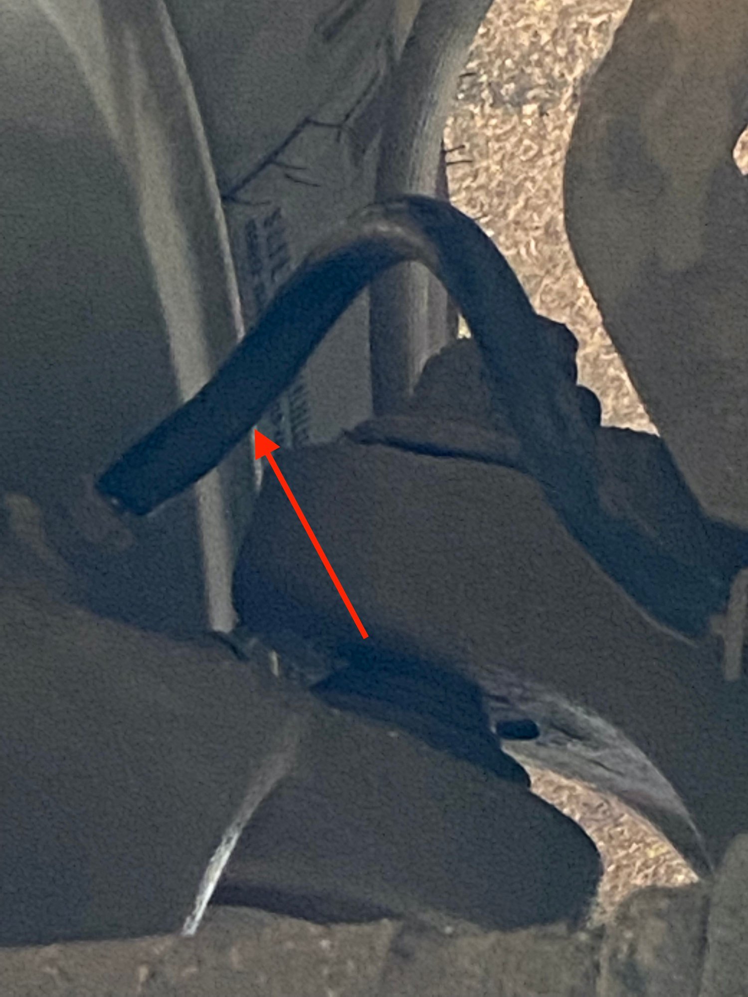

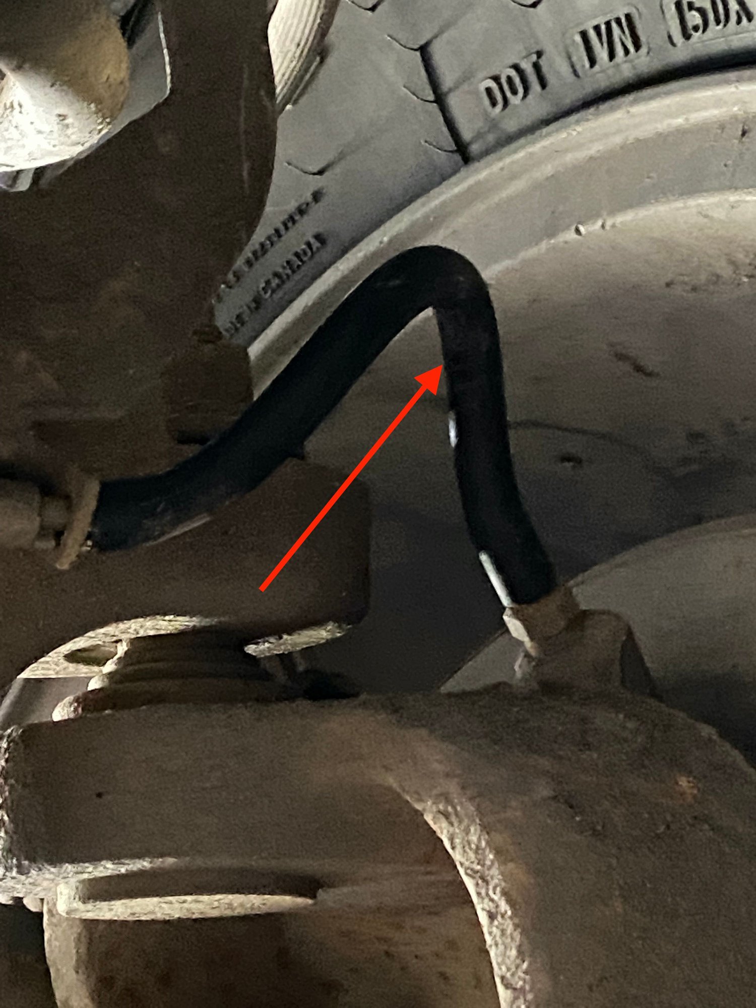

In case anyones wondering the location of the vacuum lines I replaced, I thought I'd do a follow up and add a couple photos. Like I mentioned initially on the visual inspection they looked fine, but when I grabbed them they were clearly broken. These photos show the new lines attached.
This is the drivers side one.
This is the passenger side

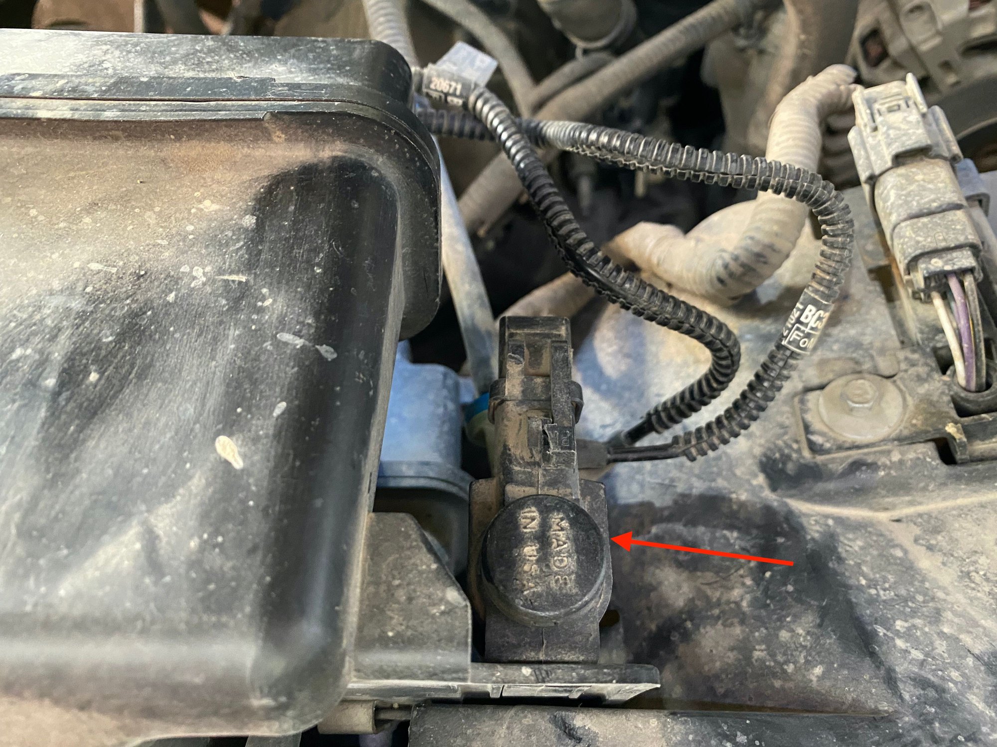

Prior to replacing them, I tested the vacuum solenoid valve to make sure it was functional. The location of the valve on my 2012 F-250 with the 6.2L gas engine is on top of the passenger side radiator (diesel engines are different) This shows the location of the valve, to test pull the top vacuum line off, connect a vacuum gauge, and turn the four wheel drive switch to 4X4 and if it's working, you should show good vacuum.
