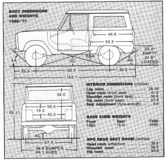

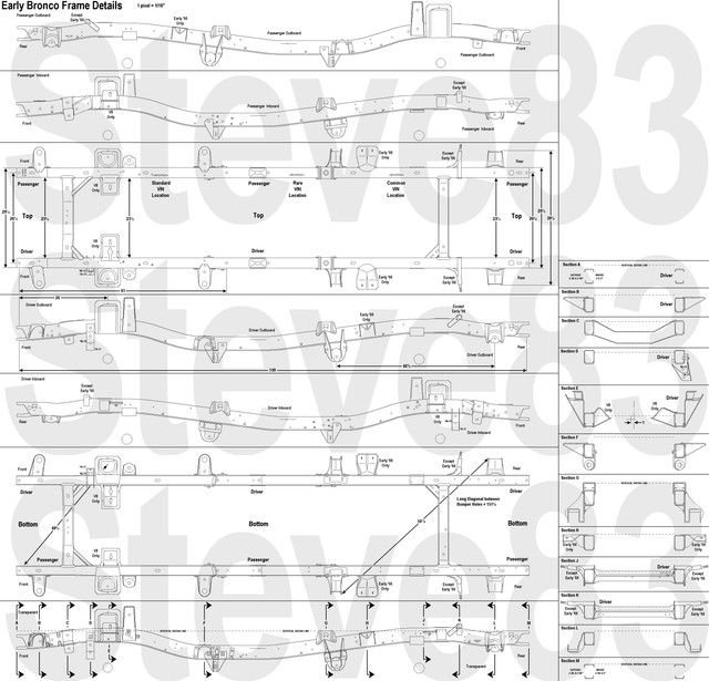

Does anyone know if there is an accurate Early Bronco Frame Bluprint available? I have new frame rails, cross members, and all body tabs, but the Vendor won't release his Blueprints. He was six months out for an assembled frame and the dimensions I can find online are a bit loose. Looking specifically for the cross-member locations in relation to the tip of the bumper horns front and rear. Appreciate any help on this.
