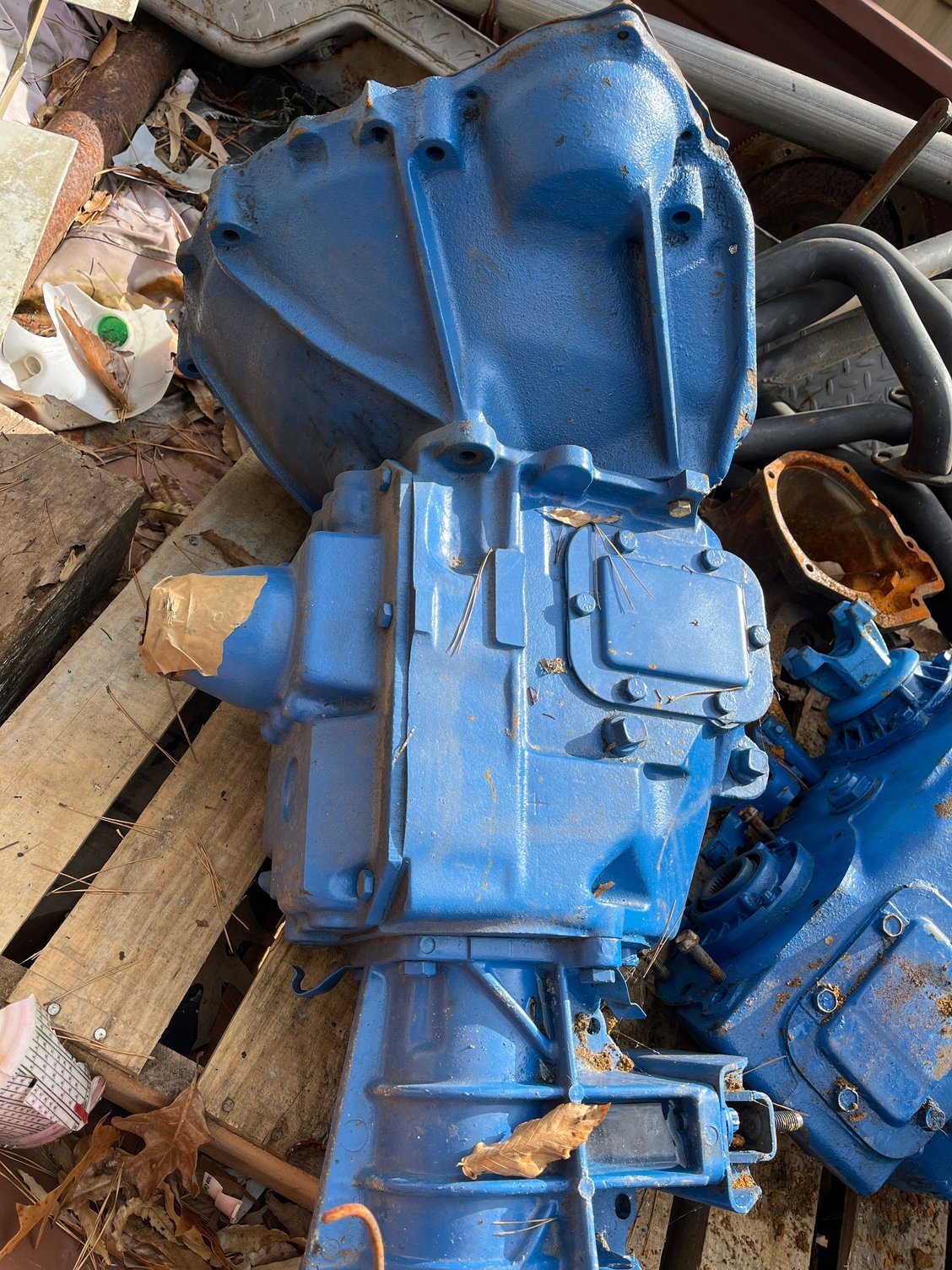

Um the c6 they took out because my cousin wanted an manual and took the c6 out the motor is 100% a 390 I’m not sure about Trans I’ll get a picture here inna sec I have clutch and pedal assembly and drive shaft and transfer case and fly wheel but idk if they are right etc

[/QUOTE]
Originally Posted by ranger140892
We can get you there. How about taking some photos for us. The grill, the door tag, a few of the engine, and a few of the transmission, and transfer case.
Idk if this will help but

i am so lost are u saying I have this trans ?

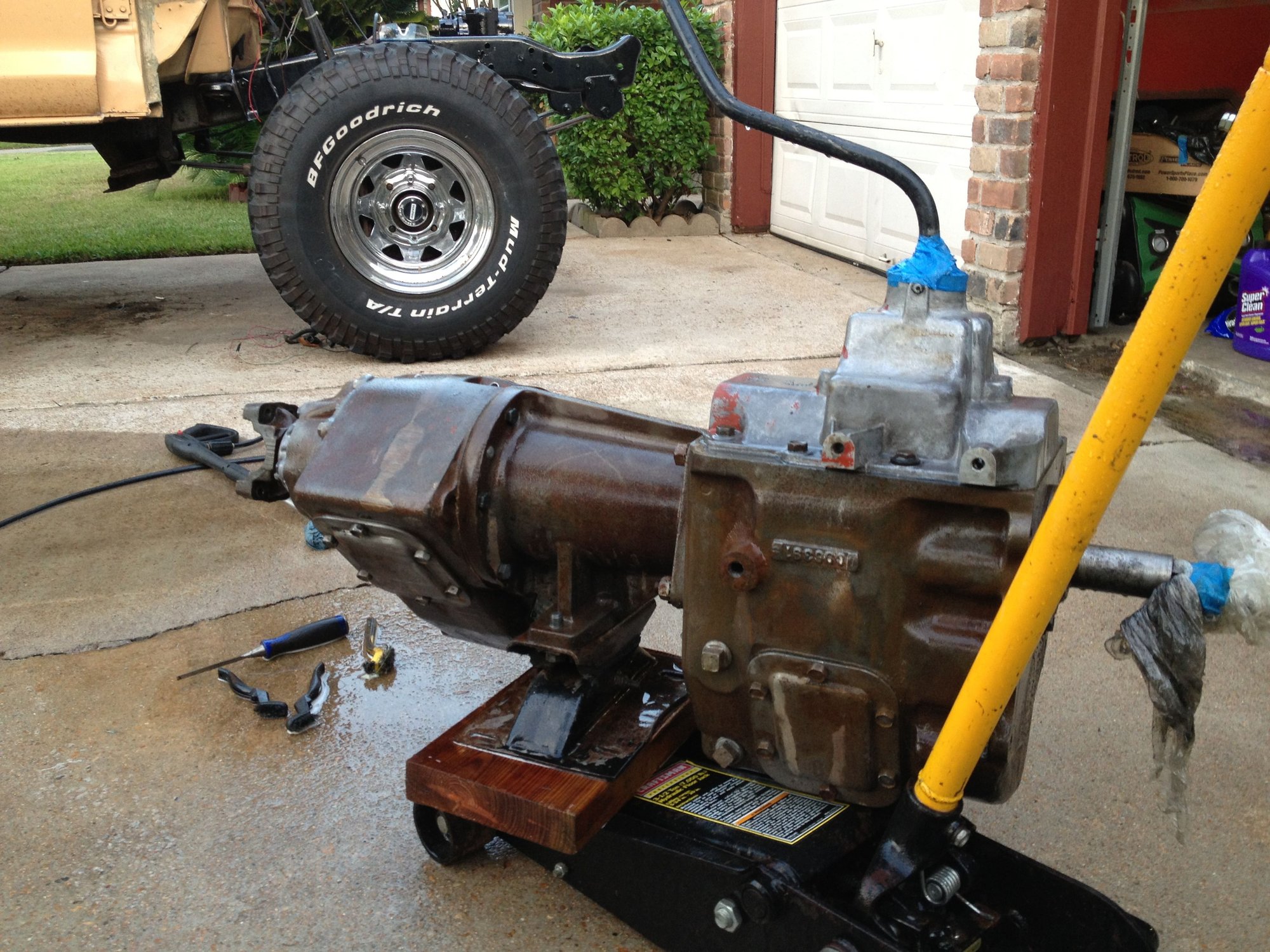

No I am not, can you take the piece of tape off where the shift lever goes in so I can see the top of the cover. Do you have the shifter lever? What does the retainer look like? Like the 1st pics below? Also look on the top cover just aft of the shifter lever hole, does it have a NP on a gear circle on it?
Alternate info source. https://www.fordification.com/tech/transID-man.htm
NP-435 below, you can see the 2 retaining pin heads just under the bottom edge of the blue tape. And the NP gear raised ID part just aft of the shifter. I would have the transmission setting up right and then cover the taped up hole with a plastic bowl and more tape. Also before you use it, you better check the fluid level.
