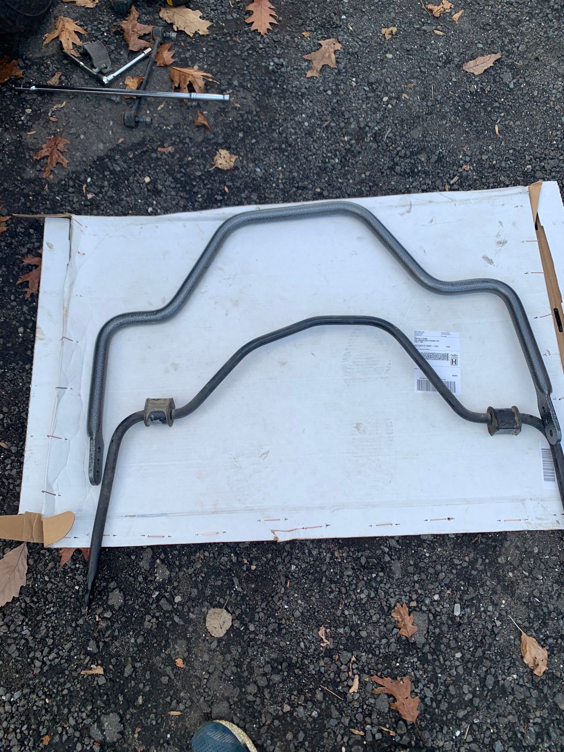

I find the air bags to be great at bringing the truck up to a level ride height, but do experience a lot of sway. Got both stock anti-roll bars off the truck today. Huge difference between the stock an Hellwig rear bar. The front will be here this week. Can't wait to get a load on and test ride.

Thanks for the comparison.
Seeing how I just put the same Hellwig rear bar on my truck last weekend (I didn't have the stock), seeing the OEM one, I would have done the same as you and swapped it out. I'm really considering purchasing the front sway bar too now.

This is why I need a sway(anti-roll)bar. I just think it makes sense to change both. Originally, I was just going to replace the rear. The front doesn't seem to be as small as some have described. Also, the front is not tubular as some have said. It is solid and seems robust enough. I couldn't imagine how something like this could have been tubular. I will put the Hellwig on anyway.
