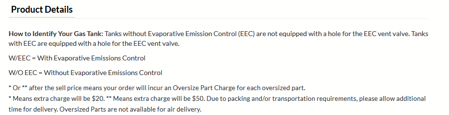

That's good info, but most of the fuel tank sellers I've seen refer to the Evaporative Emissions Control as EEC. The original question is correct as asked about fuel tanks. I don't have access to original Ford documents to verify what terms they used, but I'd expect the aftermarket vendors are taking terms from Ford, not making them up.
https://www.lmctruck.com/1973-79-for...tank-and-parts
