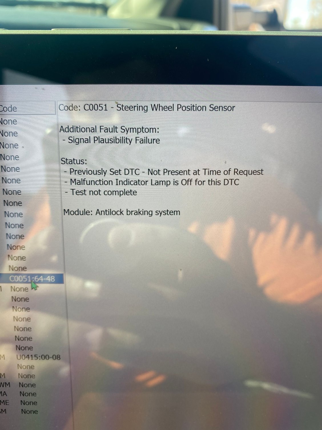

hooked up to forscan last night, i think you may be right but time will tell. the error shown (i cleared it before taking a screenshot unfortunately,) showed a short circuit to battery in the ABS module.
i went through a forced self tests on the PCM, TCM, ABS which all came back issue free, and also recalibrated the trucks accelerometer which cleared up a small discrepancy on the "offroad" tab showing my steering wheel slightly cocking 1* to the left under a small amount of steering. since these procedures, i havent had any of the error messages show up but ive only driven 10 miles or less as i work close to home.

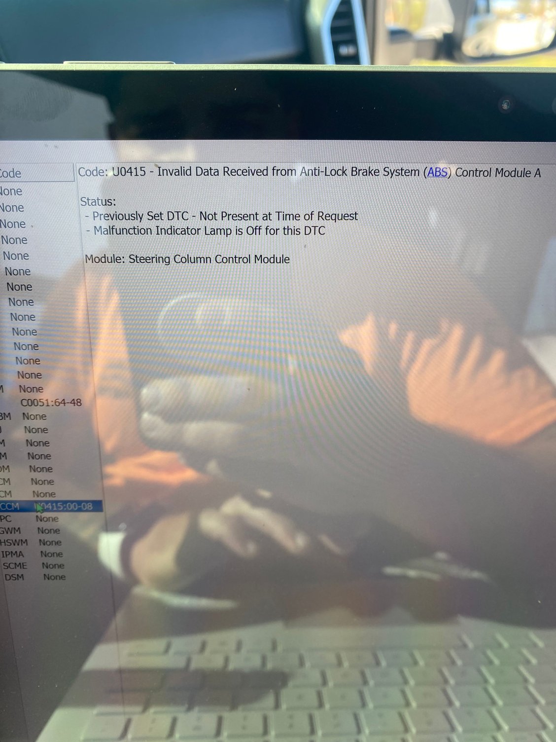

Here’s the codes from FORscan.

Did you use a new pitman arm nut(comes preloaded with threadlocker) when you did the lift? Your pitman arm may be loose and you're getting movement.

Ok I think I’ve found the solution. Had a friend wiggle the steering wheel while laying under the front of the truck and the nut on drag link where it bolts to the pitman arm was loose. Like so loose the cotter pin was all that held it on. This probably also solved the pop sound when turning tight, such as a parking lot or backing in my trailers.
will update if the error codes persist. Thank all for the help

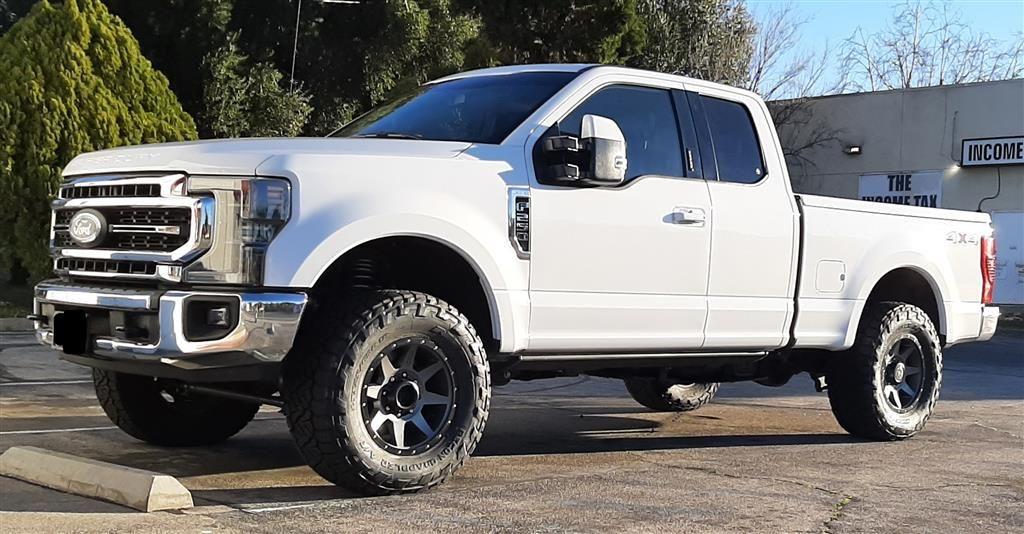

Soooooooo..... How bout a picture of the truck?
happy you asked
The white truck is a 2012 CCSB 6.7, lifted 6” on 37”s
