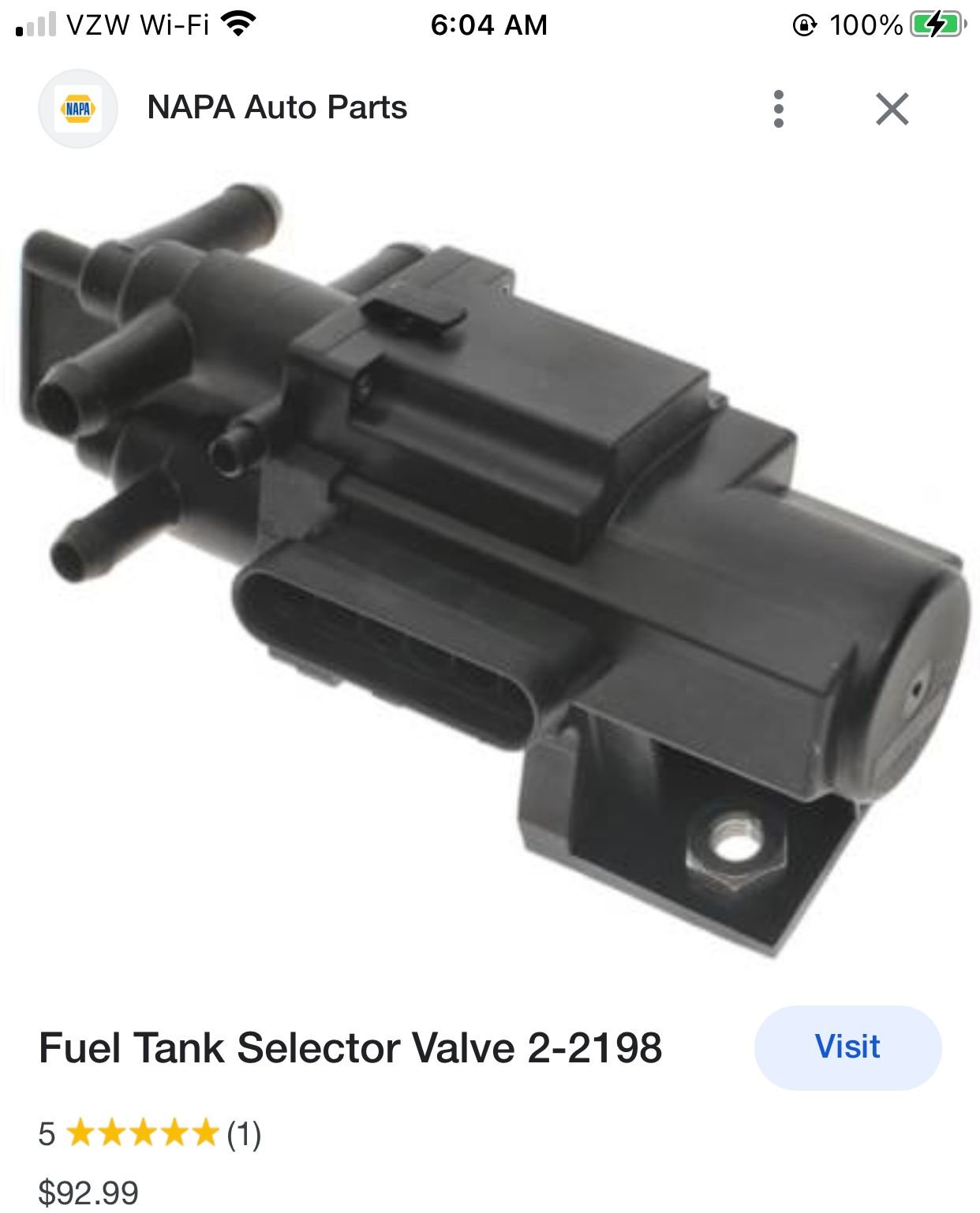

89 F150 4.9 4 x 4 manual transmission breaking in my cam and now the fuel tanks electric valve decides to quit and my fuel push pump on the rail is not filling my carburetor. So where do you guys recommend the fuel tank selector valve to be sourced from and what style should mine have? Factory dual tanks and I have a pressure regulator upfront along with the return line. My front tank is absolutely chock-full my rear tank apparently doesn’t work but it is at about a half tank now after I put 4 gallons in it. My front tank registers 1/8 tank tops n dash switch but it’s full!
So I think my tank selector valve is bad I can feel my electric fuel pump working but it’s not producing any pressure up top

Make sure the in tank pumps are working pumping fuel up to the tank selector valve. Then check to see if fuel is passing thru the reservoir

Easy way is to disconnect the supply line's to the selector valve and see if it is pumping gas out of tanks.

Then since you have the electrical tank valve may have to make sure it is working correct, front tank/rear tank wiring and plumbing. And I have not done one of them but I have seen a few post to do conversion.
Sorry I linked you to the old mechanical reservoir valve.
