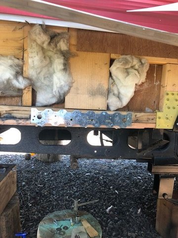

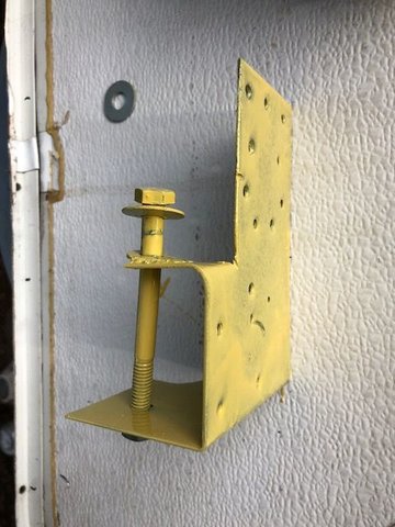

I really don't know what has kept the body of the trailer from coming loose from the chassis other than weight and attatchment at the rear door frame.
At each chassis to body anchor location, the manufacturer simply ran a 1/2-in x 3-in long Lag Screw up into the 2x2 sill plate splitting the sill because of lack of pilot hole. Cheezy peezy construction techniques by Mega-Lite. Any sane white boy or mexican can do better with a bit of effort.
The worst anchor point was at the rear of the passenger side fender-well Body-to-Chassis anchor. I could spin the lab bolt with my fingers, and the sidewall of the trailer was pooching-out beyond where I should be. I wound up removing the bottom piece of aluminum lap siding to conjure up some sort of metal plate to srew to the trailer wooden framework 2x2's and also have a hole to accept a 1/2-in hex bolt to positively anchor the wall framing to the chassis.
Believe me, I spent hours makiing up the new anchor plate and getting it all pre-drilled and screwed in place.
See beloow:
Above photos showing my positive anchor plate I made up to bolt the side wall framing to the chassis. _ _ it's not coming loose. ( I hope ).
Above photo shows where I spliced the chassis rim 2x2 to the wall sill 2x2 where the awning lower brace bracket attaches.
Of course the manufacterrer, Extreme, just ran lag screws into the assembly with no pilot holes which separated the two ply 2x2's.
Now being glued and screwed with a Sympson Tie-Plate and new hole drilled, the awning lower bracket is hell for stout.
Remember: there is not much purchase into a 2x2 piece of hem fir, so to prrevent splitting, all locations were carefully pre-drilled and I used either no. 8 or no. 10 torx head screws generously. i just got burned out doing the one anchor point, and haven't modified any of the other locations of wall framing-to-chassis anchor points.
