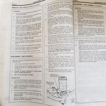

Section 13 in the Ford manuals
Here is a couple of pages
You can get ball this for free at your library on AllData or Mitchell

You do not need a vise or any holding fixture
I just clean them up in the solvent tank and rebuild them on the bench

Thank you. My Haynes manual has the overhaul also. Any chance you could get higher res pics of the Ford one?

Not easy, that is a picture of a book I have with my crappy phone
At the library you can print out the pages and take them home for free
I go twice a week most weeks looking up oddball Mercedes or Audi stuff
If I were to print out the pages at the library for you, I'd still have to take a photo of them to put on this site
I have tried to email myself the pages from the librarys computer system and cannot seem to be able to do that yet
