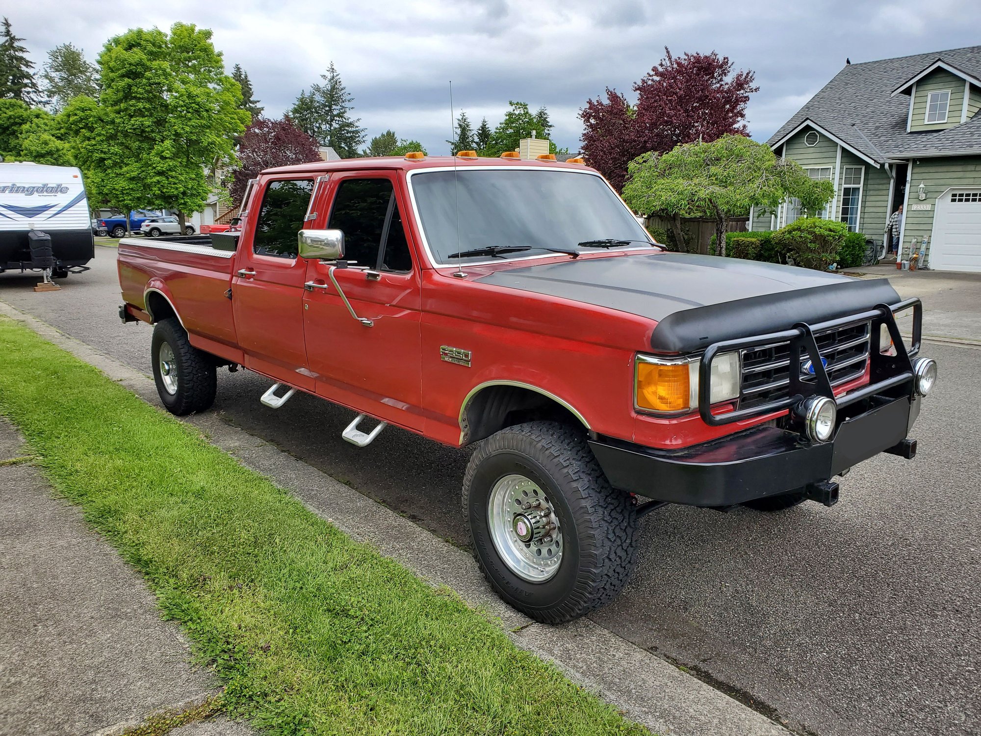

Hello, everyone!
I bought a 91 crew cab long bed f350 with a 460 coupled with an e4od transmission a few months ago. About a month after I got it, a seal on the trans blew out and dumped all of the fluid in a sonic drive through (we still got our milkshakes though lol). Since that happened though, I've been thinking of what else could go wrong.
What are some general things that should be checked or replaced beyond the basics?
I've changed the oil, checked fluids, new plugs/wires, new aftermarket cone filters, new full exhaust and a few other minor things that I can't think of off the top of my head.
I bought a 3g alternator to replace the 2g it currently has but have yet to do the swap. The truck does have a slow parasitic draw that I haven't figured out yet as well.
