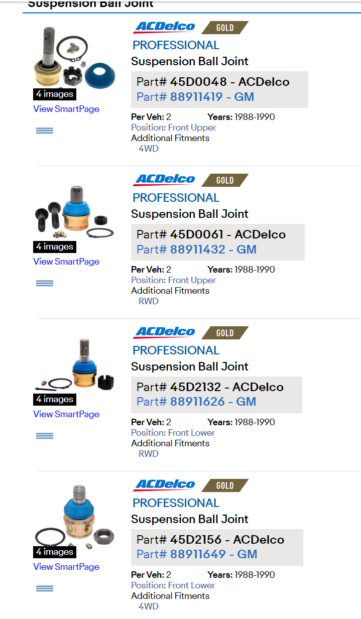

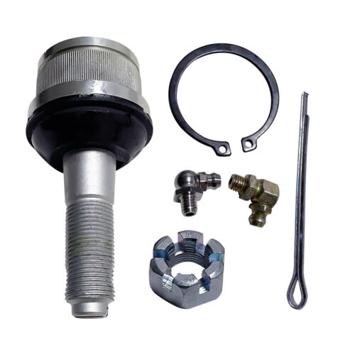

top and bottom are 4wd ball joints, visually, do they look similar?
here is your part

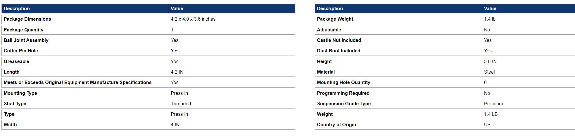

specs
this is the cross list for moog on the ac delco part(the top one, the upper one)
