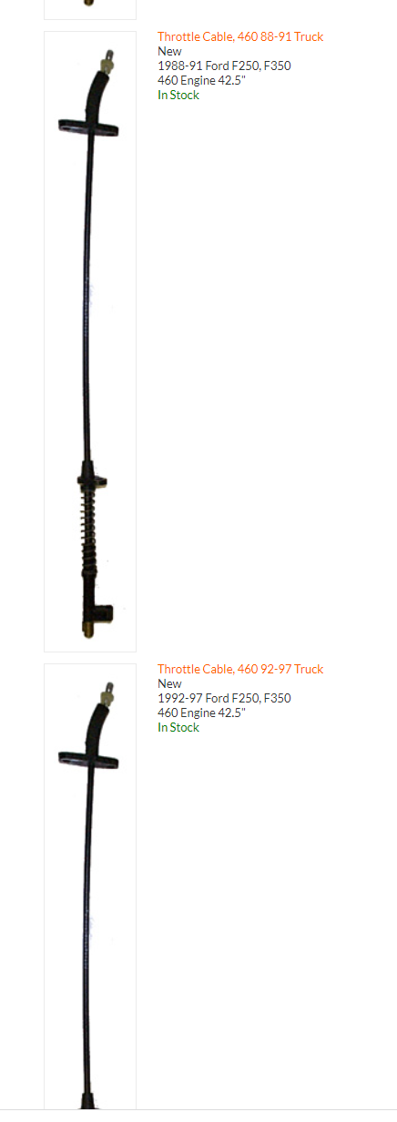

I would bet they each have a different "travel" designed into them. My guess is a throttle body or carburetor(if applicable) difference in the closed-to-open on the plates
https://shop.broncograveyard.com/Thr...ctinfo/30796A/

Look closely at the shape of the case end that attaches to the engine. There are two different mounting styles, the "square-ish" one with 4 mounting tabs is 43 point some inches, and the one with one oval tab is 42 point some inches. The length probably doesn't matter a whole lot, but the mounting tabs do.
