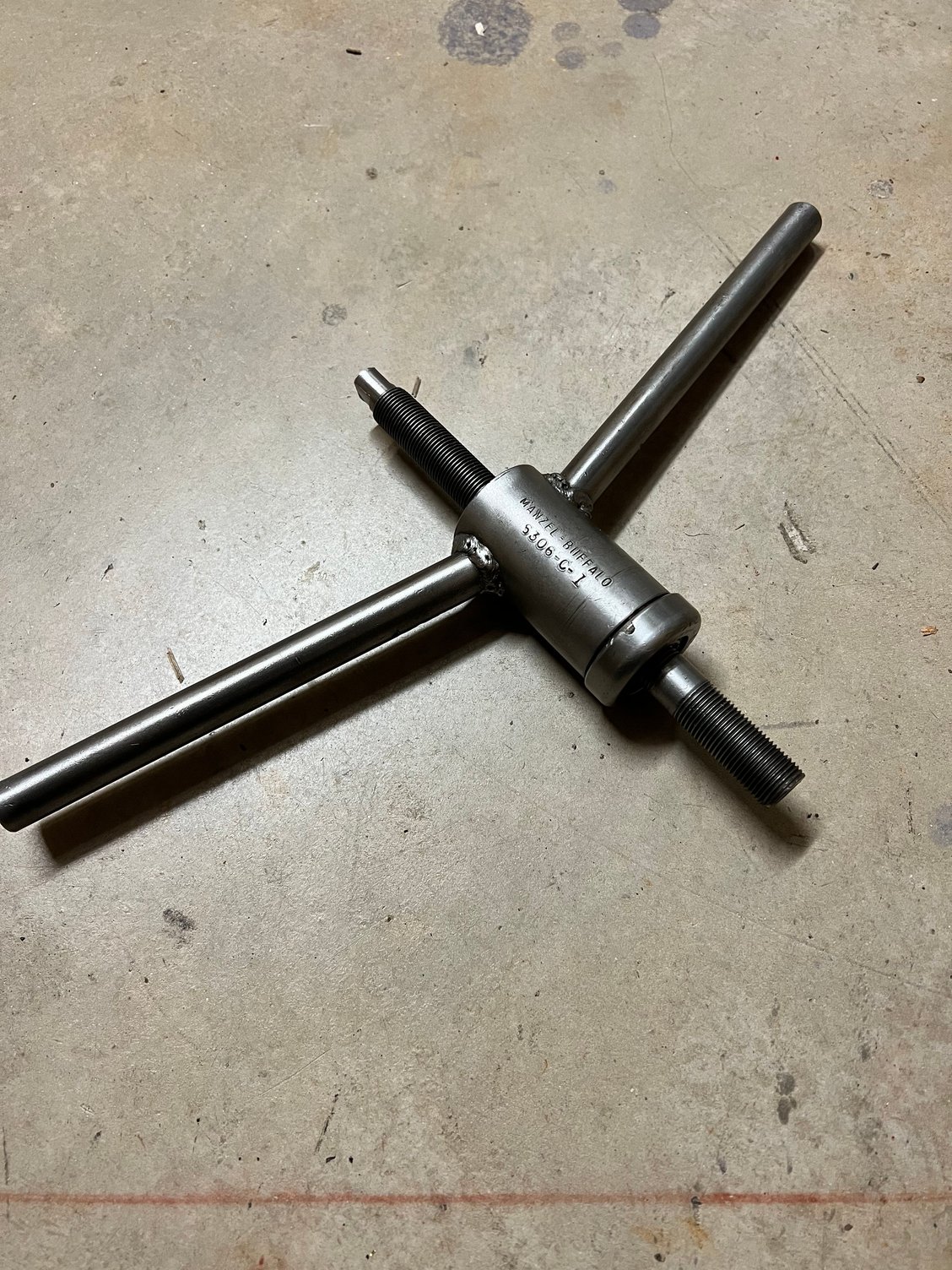

The 226 crank pulley is a tight fit, thus the tapped holes in it for removal. I would use a harmonic balancer installer that you should be able to get or even rent from a parts store. Here is the manzel installer.

I was able to get an install tool from O'Reillys and installed the pulley. Took a lot longer to drive to get the tool than it took to install the pulley.
