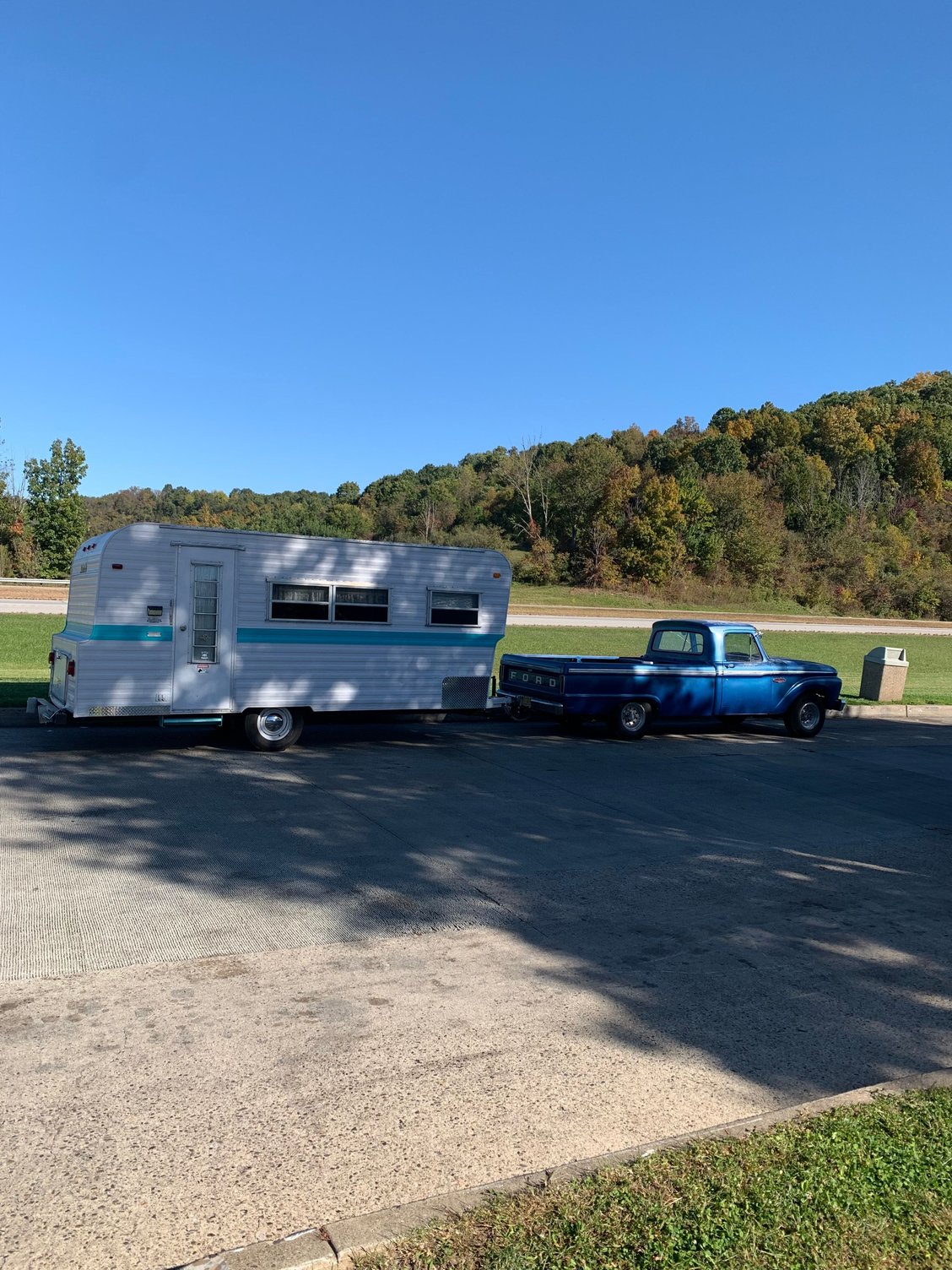

So we bought a vintage camper trailer, and went to go pick it up last weekend, about 800 miles each way. The camper itself weighs around 3k lbs.
Our truck is a 1966 F100, original 240, C4 trans, 3.50 gears. Running gear is all stock and all original as far as I know. This truck is rated as 5k lbs towing capacity. I ran a trailer brake controller and installed a class 3 Draw Tite hitch, and also used a weight distribution hitch from Curt.
So now that you have the background, here’s how the trip home went…
Most of the driving was up huge hills through West Virginia and western PA. The truck could barely make it up the hills… I’m talking maxed out at 25 mph with the gas pedal floored. A little scary on highways when people are flying around you going 80 mph, I was scared we were going to get rear ended by someone not paying attention. But yeah, on perfectly flat ground she’ll pull the trailer at 60 mph no problem, although it takes an hour to get up to speed, lol. but on any kind of a grade… forget it. The most it will do is 25 mph. I had to disconnect the kickdown so it would stay in 3rd gear, otherwise it kept bouncing back and forth between 2nd and 3rd the entire time trying to make it up the hills.
We eventually did make it home. No overheating, the temp gauge normally sits at around 1/4 and at most on some of the longest hills it got up to about half, but never any higher. I did check all the fluids constantly, and noticed on the ride home the oil had some creamy whiteness to it, which it never did before and hasn’t at all since, so that’s kinda weird.
Anyway- lessons learned are… definitely going to install a trans cooler and contemplate power disc brake upgrade, although the trailer brakes did a great job, so believe it or not braking down some of those steep hills with the original drums wasn’t all that bad.
But why was she straining so hard to get up those hills? I keep hearing about how these L6’s are built for torque and can tow almost anything. What’s the weak link here? The motor just being tired and old? The trans? Rear gearing? What should I look at first?
