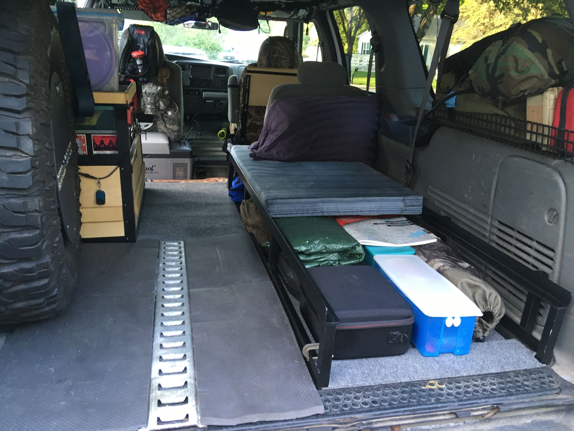

I vote for E track or X track. You can bolt it to the floor pan using lag bolts. Just make sure to check underneath where you’re drilling so you don’t hit the wiring harness or other sensitive items.
I use similar in my camper conversion. I adapted old seatbelts instead of tie-downs because they disconnect and re-secure easily. I just attached them to the E track clips.
