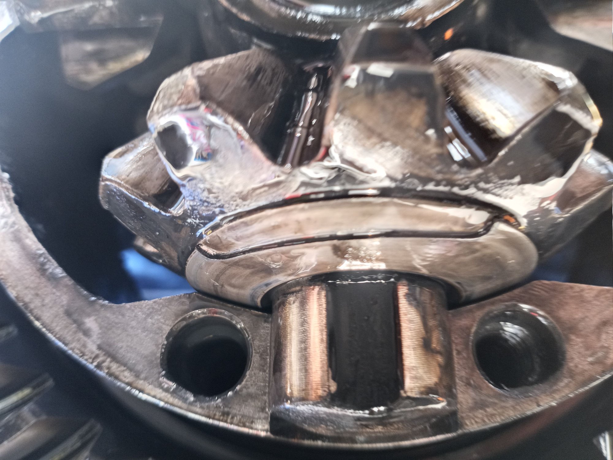

I have a 2000 F350, 7.3, 4R100 and probably a 10.5 rear end.
After checking fluids today I got this!!!
Where did this come from?
Was on the magnet fill plug for rear diff. Concave and as is it will be about 2 inch OD.

I'm guessing it's a carrier shim. I wouldn't be too concerned just yet, they're thin (sometimes a few thou which is, well, literally paper thin) and can break off if hammered in incorrectly, ie proud of thicker shims that can take the beating.
Yukon even markets radiused drivers for this purpose.
If you're so inclined pull the diff cover and have a look. You'll need to pull the carrier bearing caps so have a torque wrench to reinstall.
But if the rear end is not making any noise....ignorance is bliss!

Thickness .03 and 3/16 wide.
My guess was thrust washer in spider gear maybe...
Rear end not been open for 300000 miles, but always had oil in it.
So when I'm going to open it I like to have the parts I need to finish the job.
Might be time for aftermarket diff cover, any recommendations?

I would not run the axle without replacing the shim. Part of that broken shim could get into the ring and pinion or cluster gears set and destroy them. Running with even an additional 1/1000 of an inch of play can dramatically shorten the life of the gears and bearings.
Read up on the correct way to do it! At the very least you must mark the retaining clamps and keep them and the shims for each side separate and reassemble them exactly as they came out. You should also measure rotational torque, gear lash and the contact pattern and reassemble as close to the orriginal settings as possible.
There are many write ups on this forum and others and videos on YouTube on the correct procedures. Spend some time studying and save yourself hundreds of dollars!

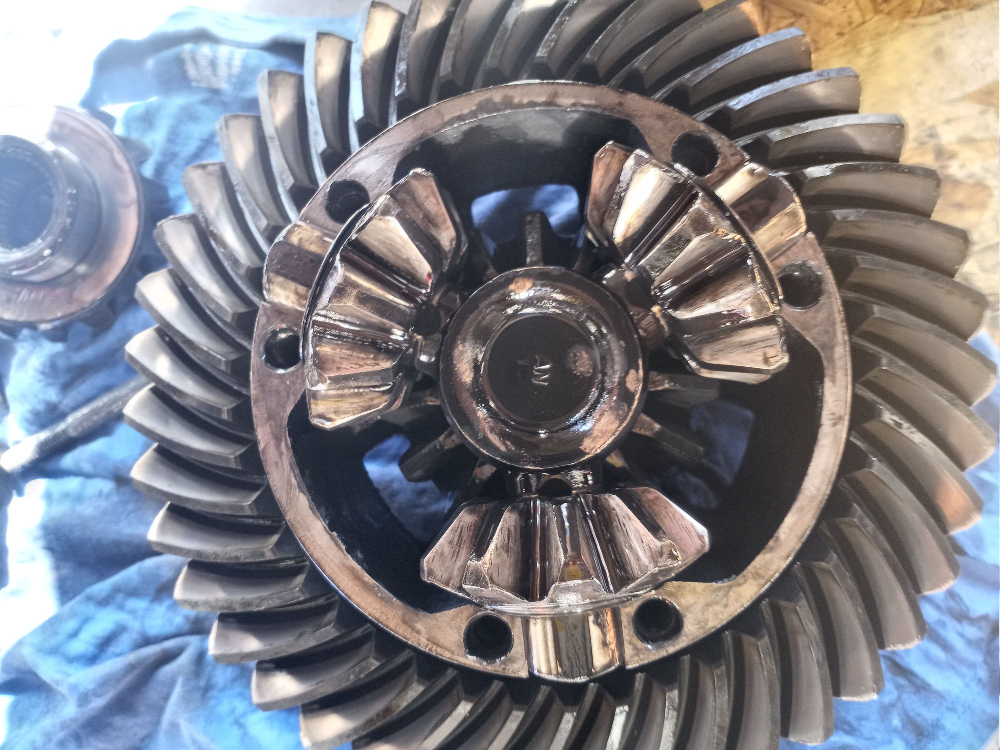

Ok, so I found where the piece came from, but I can't find a parts diagram or a part number.
Totally disappointed I don't have the limit slip diff on my 4x4 as a "friend" pointed out and said it was the belleville washer.
