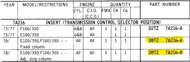

I know it says it's for up to a 77 bronco but will this work in a 79 f-100? I feel i may need to fix mine:

Looks a lot like this one. Look who the seller is. I'm gonna assume no. The columns changed for 78 and 79 and I'd imagine their listing would go to 79 if they were the same.

That part changed in 78, and is different between tilt and non-tilt column...
