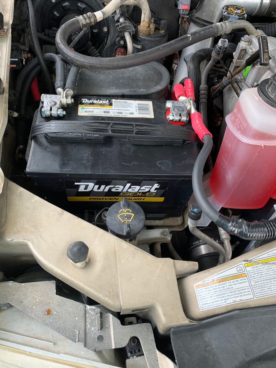

Old Oct 17, 2022 | 01:12 PM
Jimmy's Pilot Service's Avatar
Veteran: Navy
Joined: Nov 2020
Posts: 992
Likes: 367
From: Republic of Texas
Something like this???

Old Oct 17, 2022 | 10:32 PM
PJWhelan's Avatar
PJWhelan
Joined: Jan 2019
Posts: 868
Likes: 84
From: Florida
That's real sharp looking!
