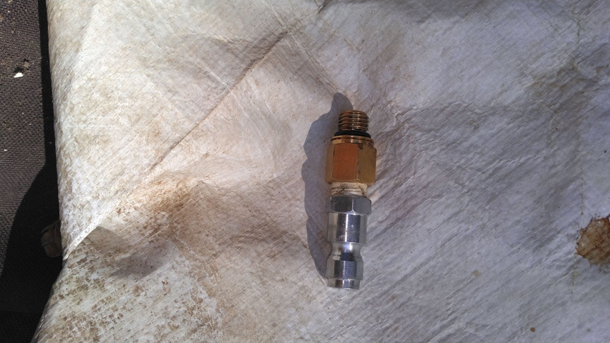

I wonder if 90 psi is enough to test the system, I had IPR over 85 % when I started working on the truck. the air pressure did not stay at 90, psi slowly went down to 0 psi
used at the IPR
what I used at the IPR sensor and the air line had a value that allowed me to shut off the air at the ICP connection.
