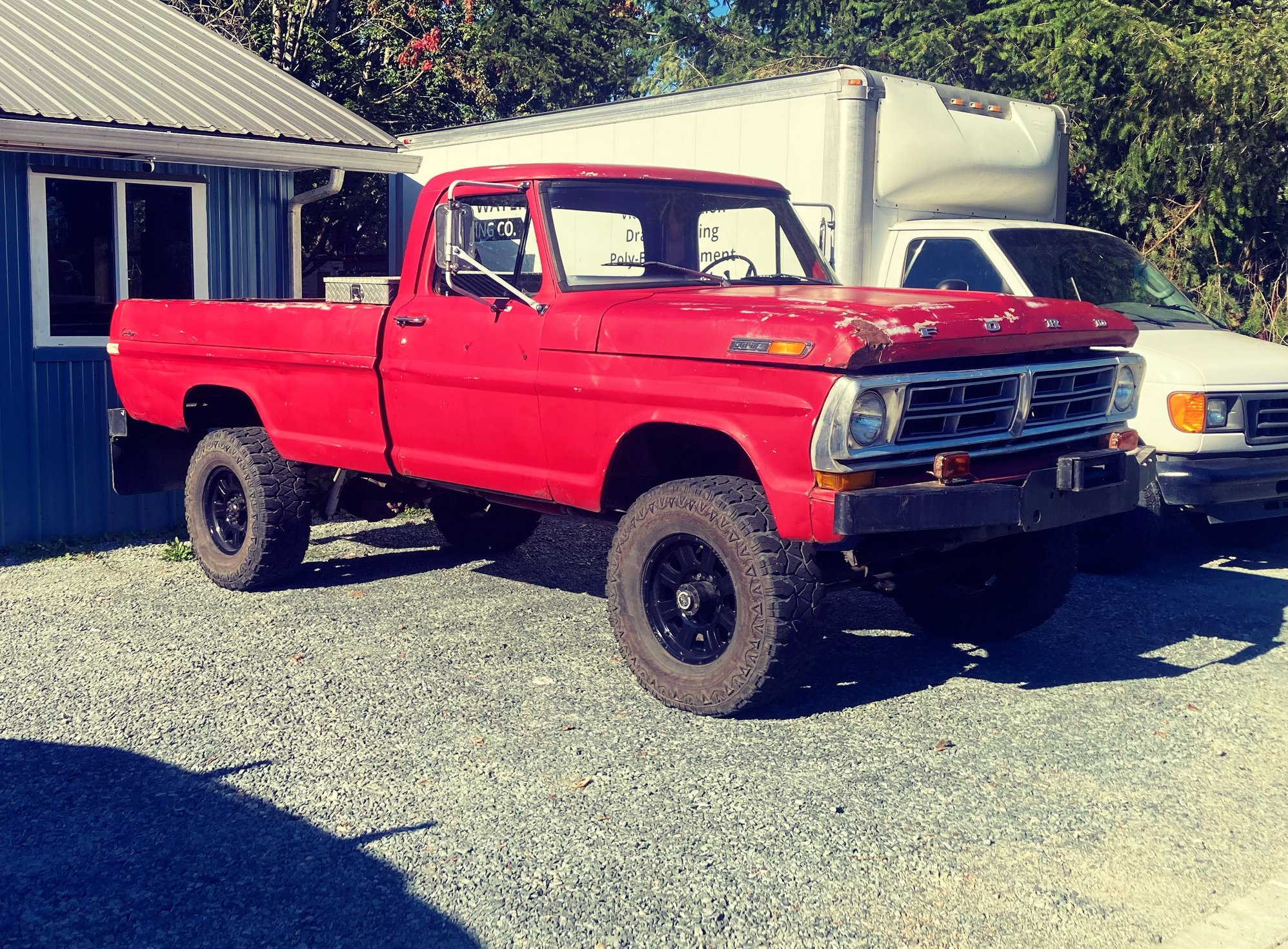

Mornin lads,
I picked up a 72 F250 with a 300 6 and an automatic
Having some minor issues.
1. I’ve got no brake lights, but the turn signals are working. I’m thinking brake switch?
2. The wipers quit on me, I seem to have power past the switch.
3. the previous owner decided to throw a fuel cell in a job box in the back. I’d like to put it back to an original in cab tank. Just as not to have to move fillers etc. How do I know if I need the emissions or non emissions tank?
See pic below

The evap/em tank would take a non-vented cap and have an extra tube coming out of it. This is a vent tube that eventually ends at a vapor storage cannister under the hood attached to the right frame rail. Does your existing in-cab tank have this vent tube? If no tank, is there an extra vent tube in the cab going forward?
