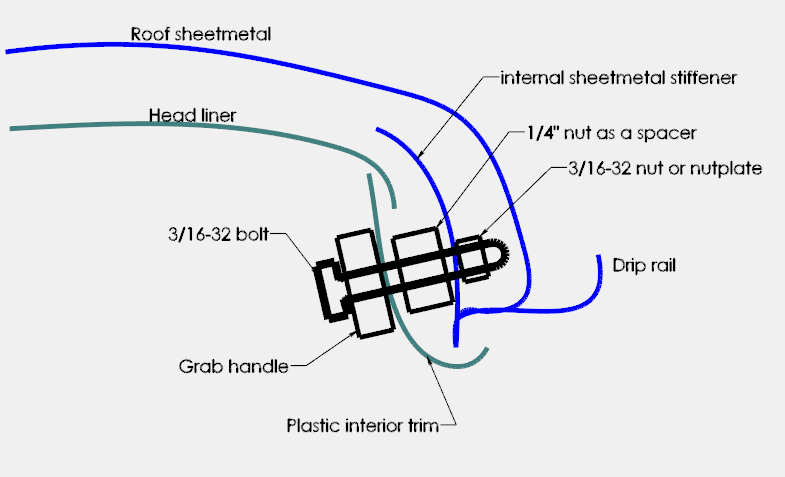

Originally Posted by Prototypemech
I got handles off a late 90's ford contour. All plastic and matches the interior.
How did you mount them so that they dont rip out from the roof? Do you happen to have pics of what it looks like without the trim piece there?

This is how I installed mine. I used glue-on nutplates to simplify installation and removal. Otherwise, you'll need to cut 2 more holes for 2 clip-nut. Not a big deal with a dremal.

Nice! we got 2D Picasso, with us, I cant even take pics that good.
would a rubber expanding plug work for that better, the well nut kind. I am not familiar with the roof sheet or the strengthening part ,since i have never had the panel out of my truck, but just curious about thoughts.
I have also heard that others made brackets that reinforce, but i wouldnt know how well they could do without also starting to add bulk/cosmetic problems to be solved
I've heard of people using well nuts for this but it gives me the heebe-jibbes because well nuts don't take shearing (sideways force) well. I'd need to do the math, but the 0.025 steel sheet metal will easily cut throu the rubber of someone puts 100 lbs on it. Last thing I need is my girlfriend using the handle to get in my truck, ripping the rubber out of the well nut, and ending up on the ground.
I'd be more comfortable with a riv-nut since they're aluminum.
Fair. Probably a steel riv nut if you had the tool to do it(harder to set)
