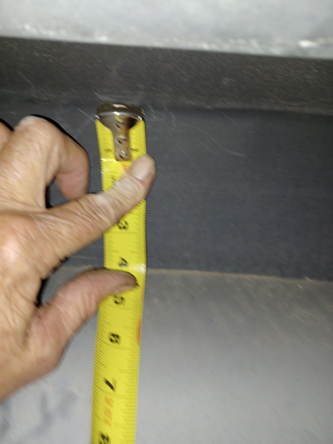

If you have both beds now, measure from the top of the fender to where the flare starts to bend out. You'll see the difference.
Report back and tell us the difference. I think it is like 3-4".

Well Abe I took the pictures but am having trouble getting them able to view here (I will fix this to upload progress pictures). The top of fender to edge of 45 Degree angle is 4 inches on at least my 54 bed and the 59 bed had 3 inches. Youb are correct Sir that the fender placement puts the fenders up to high, but you already knew that. I took pictures of each bed and want them up in case anybody wants to see them. Respectfully Kurt G.

My 54 bed
My 54 bed
59 Truck bed trailer

Actual difference in bolt hole placement is 1-1/2 inches as measured at the center mounting bolt...the later model beds have the holes drilled higher.
